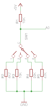

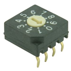

No, some types do remember. Binary encoded switches like this one do remember but quadrature encoders don't remember. With the binary encoded ones you would probably need 5 resistors to distinguish the 10 positions with an analog input, or use 4 digital input pins and no resistors (just internal pull-ups) if you can afford that.
You could wire one up like this:
Which should give these approximate readings:
position analogRead()
0........ 1023
1........ 695
2........ 511
3........ 775
4........ 319
5........ 737
6........ 606
7........ 799
8........ 179
9........ 716
Paul
PaulRB:
The usual rotary encoders don't. Your example is a switch not a rotary encoder however it is a good solution for the OP.
