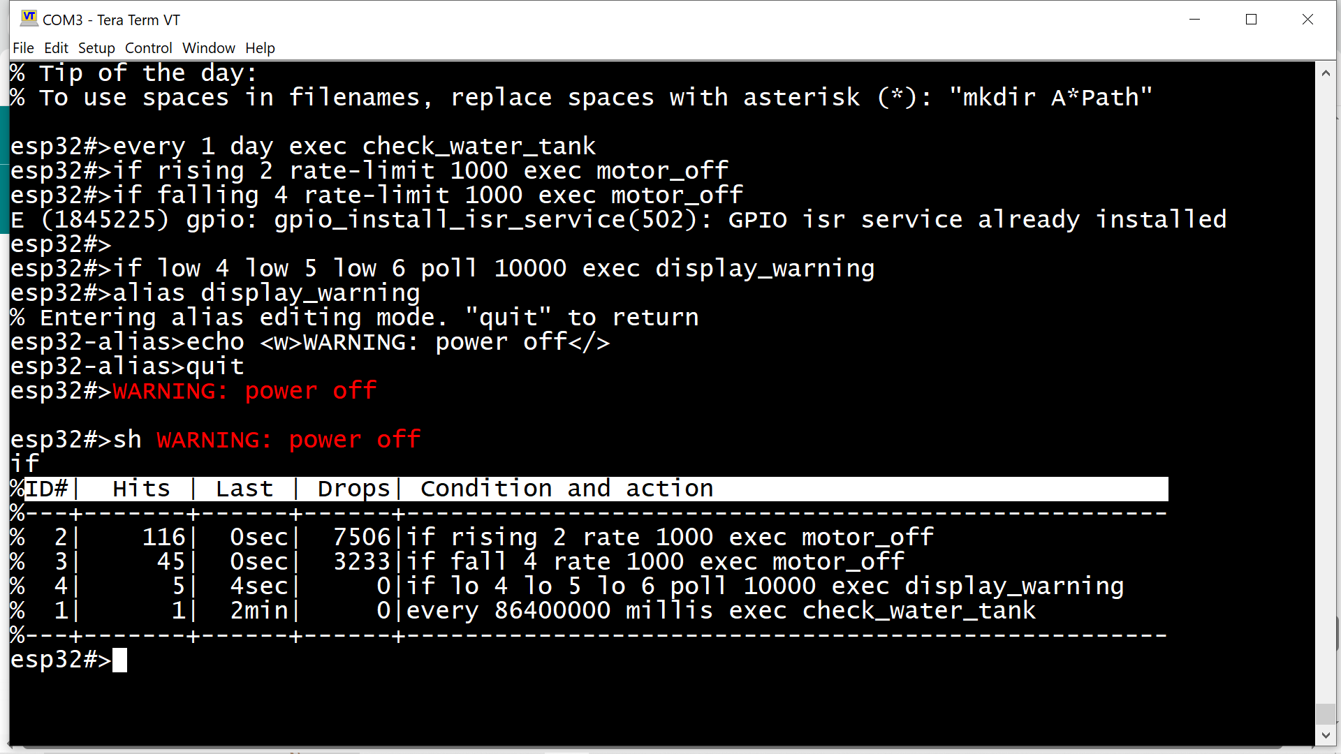

**Author:** ![vvb333007](https://dub1.discourse-cdn.com/arduino/user_avatar/forum.arduino.cc/vvb333007/32/974521_2.png) [@vvb333007](https://forum.arduino.cc/u/vvb333007)\
**Post date:** [August 10, 2025, 3:12pm UTC](https://forum.arduino.cc/t/development-debugging-tool-for-esp32/1302200/9 "2025-08-10T15:12:30Z")
</div>
Messy screenshot.
Creating “rising“ and “falling“ conditions and actions. Creating periodic events.
 ![image](https://europe1.discourse-cdn.com/arduino/original/4X/8/6/0/86067a20eb3cfed8f2bae1aef228693b07474663.png)
Started a doc for this feature, [Aliases and Events : creating and executing shell scripts](https://vvb333007.github.io/espshell/html/Aliases_And_Events.html) but it is far from being finished :D. Writing documentation is harder than writing code.

For example, suppose we want to access memory at address `0x3fce4000` as if it contained an `unsigned int`. And we also want to access memory at `0x3fce4004` as if there were an array of 64 `unsigned int`.
We simply create two variables: `foo` and `bar`:
 ![1](https://europe1.discourse-cdn.com/arduino/original/4X/d/1/7/d1713539a132c2f21bc1d09d7bb08eca019d52e0.jpeg)
Now we can read the value in memory as if it were a variable. We can also modify it using the same shell commands. For example, print the current value, change it to 10, and verify that it was written correctly:
 ![2](https://europe1.discourse-cdn.com/arduino/original/4X/b/6/d/b6de8dc59d29dce7172a0fc57806c57762663e31.jpeg)
And here is our array, variable `bar`. Access to individual elements works exactly the same as before:
`var bar[666] 10` → sets element 666 of the array to the value `10`.
 ![3](https://europe1.discourse-cdn.com/arduino/original/4X/c/6/5/c6597dff9fb52914a70b993a2c0d350b87cbfe16.jpeg)
The following types are supported:
- scalar types (`uint16_t`, `signed short int`, `unsigned long`, etc.)
- pointers (`signed short *`, for example)
- arrays (`int []`)
- arrays of pointers (`void * []`, etc.)
and similar combinations.
Why did I implement this?
Right now I’m digging around in various structures in memory (WiFi driver internals). These structures are meaningful data structures, not just a raw byte dump, and I wanted to be able not only to view memory as C types but also to write to it.
And to do that without worrying about byte order and similar details.
For example, you could map variables onto the UART registers and read/write them as if they were an array.
There are still some small bugs showing up here and there, but I think I’ll polish it up soon and commit it.
