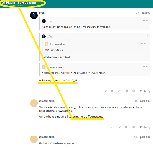

Did you try shorting GND to IO_2?
The issue isn't low volume though - but noise - a buzz that starts as soon as the track plays and fades out over a few seconds.
Will try the volume thing but seems like a different issue.
Or that isn't the issue any more!

Ah. I did try grounding IO2 - but it didn't make a difference - sorry I should have said.
The problem is this noise now not the volume - the volume was fixed by getting a new player as I mentioned above
If this is true, you did something wrong. IO_2 and IO_1 directly change file or volume depending on duration of grounding.
