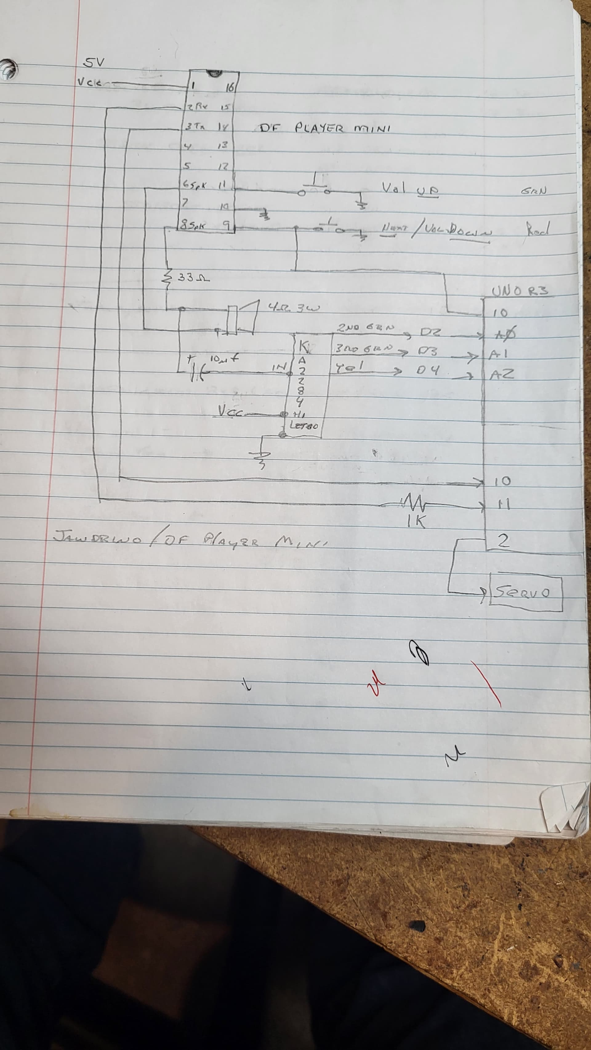

Ok I have a working version of Jawdrino (as seen on YouTube but so old not I dont get a response) This is great project and I have successfully incorporated a DFPlayer to play .mp3 files. Im using a Arduino Nano.
This all works great however I have been unable to get the DFPlayer to wait to finish a track before playing the next. The basic code I am using to control the DFPlayer has a timer that I have not been able to program around to make this work properly. Looking over and trying several commands have not worked.

Overall intent is a prop to play .mp3 files while moving a skull jaw

You didn't mention which DFPlayer you're using, but if it's a Mini, it has a BUSY pin. You might want to ponder what use you could make of that.
Ahh yes. Your correct..a re-read was needed.
Yes Im using a DFPlayer mini.
...and yes I did make some attempts using the BUSY pin but my inexperience with this held me back.
The code should now be listed.
Sooo. I was able to find a sketch with help from "markd833" for using the BUSY port on the DFPlayerMini. Thanks again for this help.
At this point I have carefully tried to copy and paste the content of the BUSY sketch I now have into the "jawduino" sketch. While I dont see any errors the servo will not move however the MP3 files play correctly.
Below is my latest attempt at getting this going. The only thing Im trying to do here is to remove the timed MP3 play time so it will play various file times to completion with a set delay between each track.
Any help appreciated.

In the end I ren out of time trying to get the "BUSY" connection to work with this sketch however with a few minor edits to the .mp3 files this now is working better. Since some of the .mp3 files were much shorter than others it now kind of mimics a random play which other liked....go figure.
Ill try again at getting the BUSY pin working with the DFPlayer mini and the Aduino nano another time.
