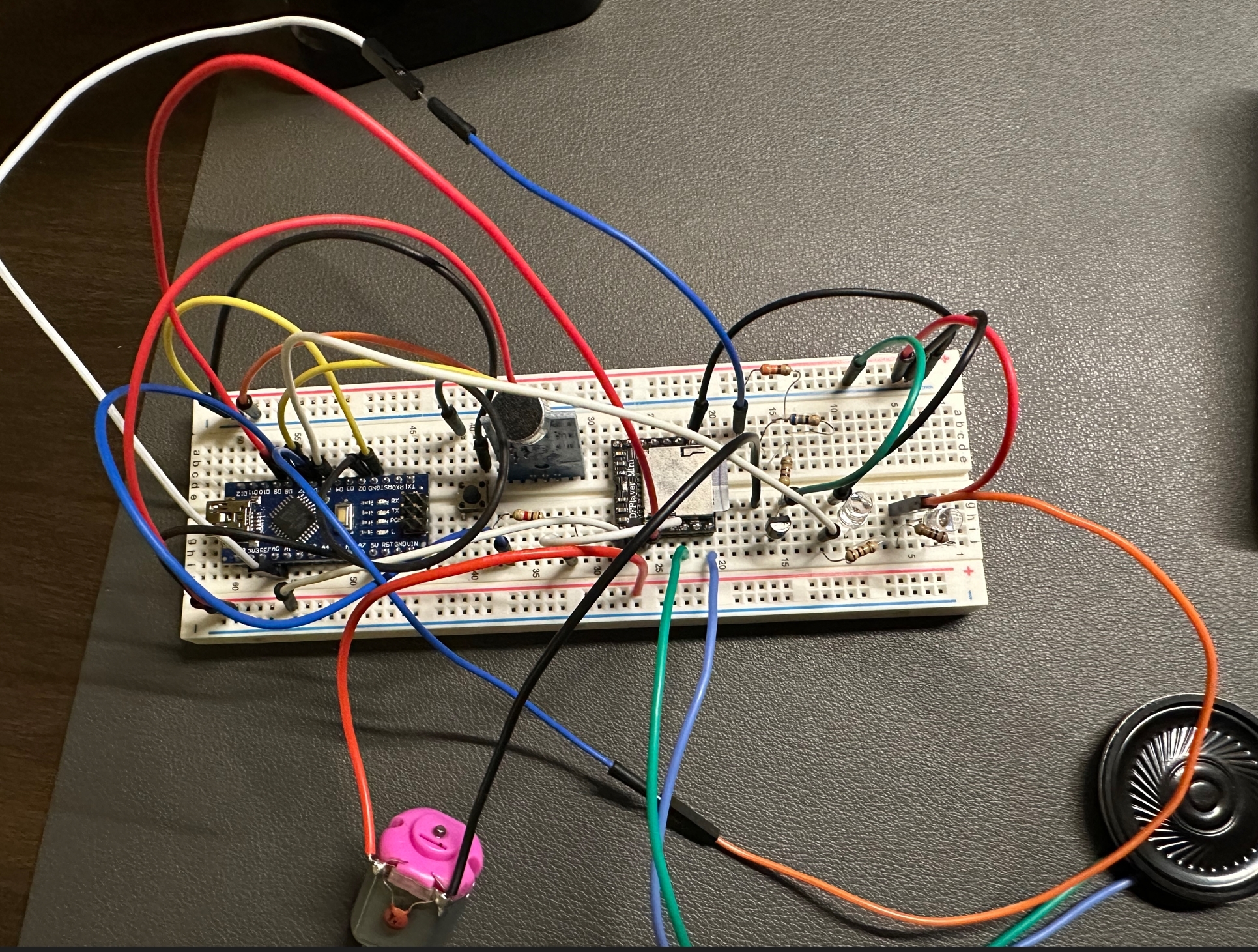

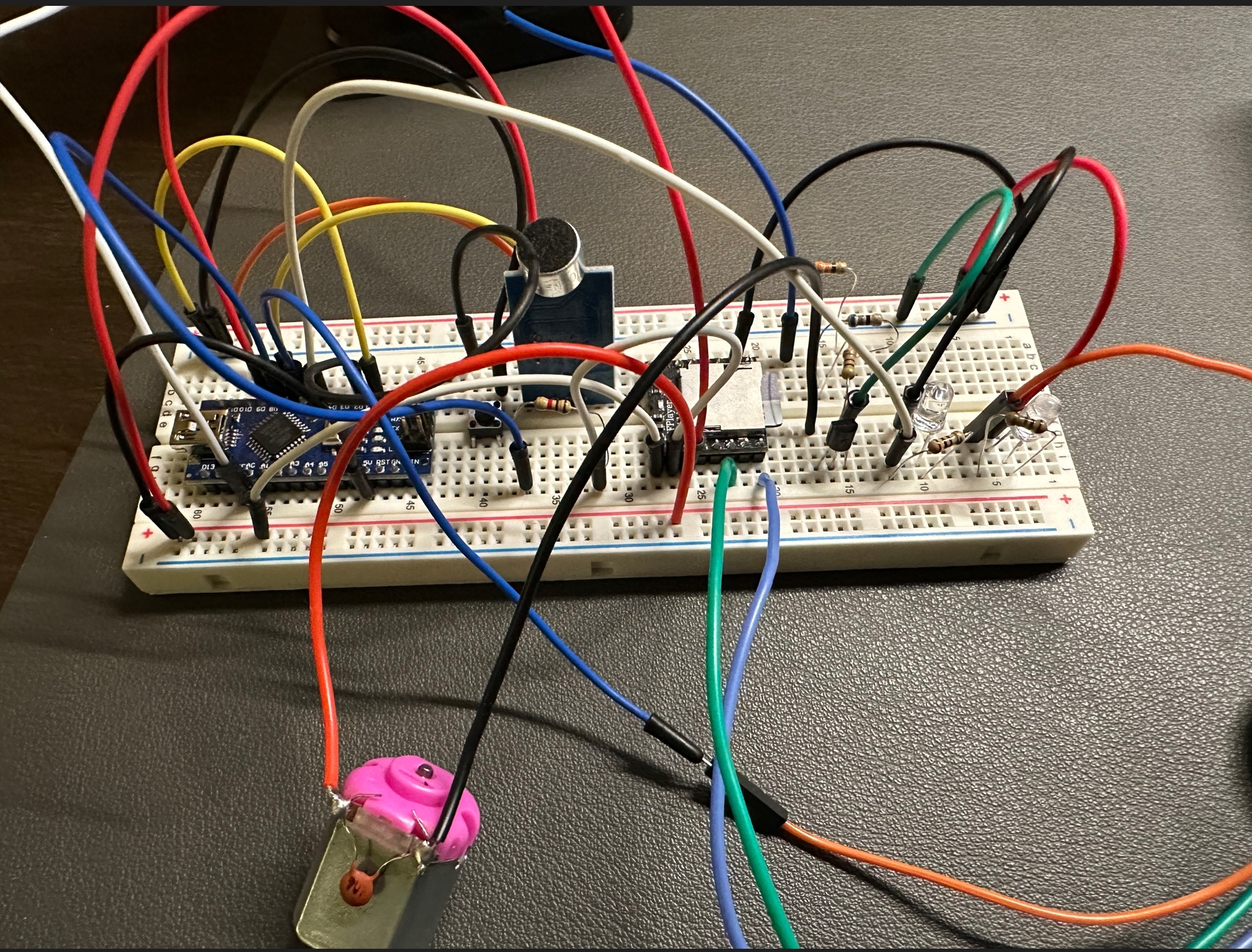

Hi! I'm making this figurine that talks and moves, however when I have both the DC motor and the DFPlayer Mini (used for audio) running, the audio sometimes plays but most of the time does not. I noticed that when the DC motor stalls, the audio completely stops. I have both connected to the 5V pin of the Arduino which I think is why it's happening but I'm not sure how to make it stop. Any ideas?
Here's the wiring and such:
https://i.gyazo.com/175dbead6bb659afa57ac7ee40e5366b.jpg

The Arduino can only just supply enough power for the audio player. It can't provide enough power for a motor. It definitely can't provide enough for both. You risk damaging the Arduino by trying this.
If you want more detailed and useful advice, please provide detailed and useful information. You have told us what model of player you are using, so thanks for that, but you have not told us what model of arduino, what motor, what motor driver or what power supply you are using.

Hi! Still pretty new to this forum, so I apologize for any concerns regarding the links. I'm currently using an Arduino Nano in my project. I, unfortunately, don't know the voltage rating of the DC motor as I obtained it from a discarded toy, but from the looks of it, I'd say it's probably a 5V DC motor. I'm using a 2N2222A transistor that essentially opens and closes to make the motor run. As of right now, I'm supplying power to the circuit via the USB connection though in the final result I plan on supplying power through 3 double A batteries (4.5 volts). I'm still a bit new when it comes to working with electronics so I do apologize for any confusion. Thanks in advance! : )
You're powering the project with V_usb (Vbus), yes?
If so, it's not a limitation of the Nano onboard linear reg.
Not all USB sockets are spec'd equally, universally (some 1/2A, some 1A, 2A), but that is your limitation. Perhaps you have a charger rated "2A" that you could try.
If that proves unsuccessful, perhaps your motor could do with some additonal noise-reducing capacitors (one positive to negative, one positive to case, one negative to case).
Measure the resistance of the motor windings with a multimeter. This will tell you what current will flow when the motor first starts up or is stalled, when supplied with a particular voltage.
You should be using rechargeable batteries wherever possible, and with NiMH cells, you will probably need a 4 cell holder. This will give around 5V which can supply the Nano via it's 5V pin.
You did not mention a flyback diode. This is very important to prevent damage to the transistor and to the Nano.

Edit: Using a multimeter, I was able to get the following from the DC motor using a 5V 2A DC adaptor:
No load: ~50mA
Stall: ~650mA
Does this mean I have to have a power supply such as 5V 2A to safely power the whole circuit?

It does, in fact, it works surprisingly well even when the motor is being stalled! However, I want to use batteries for my project, not an adaptor. Any ideas on how I can make it work that way? Thanks in advance! : )

Reverse polarity of what? Incorrect connection of a PSU or battery pack? I am talking about protecting the circuit from the reverse polarity created every time the motor spins down when the current to it is switched off. A flyback diode allows that reverse polarity current to dissipate harmlessly.

You need a power supply/battery that can supply the maximum current your components need and do that with a voltage drop that is small enough that it that doesn't cause unwanted side effects such as the Arduino resetting.

On top of various diode protections, my usual advice here would be:
separate your chips, audio player,logic supply away from the supply to your motors by a small resistance (your logic chips won't draw much current so you likely wouldn't lose much voltage across 10 ohms or so.Then put a huge quanity of decoupling capacitors (10uF ceramics if you can afford plenty, they dod make them in through hole as well as SMD) between the logic chip's power rail (that is to say after the series resistor) and ground. The resistor and decoupling caps will ensure the logic chips keep geting full voltage for a while whenever the motor's current draw would have previously threatened to brown them out.

Not really, no. Measuring the resistance of the windings would confirm what the stall current should be. You said you measured around 650mA with 5V, so the winding resistance should be around 5/0.65 = 7~8 ohms. To measure the winding resistance, put your multimeter on resistance range and connect it across the motor terminals (disconnected from the rest of the circuit).
Ahh okay got it! Also, I checked and I got 7 ohms like you said. Thanks! : )
