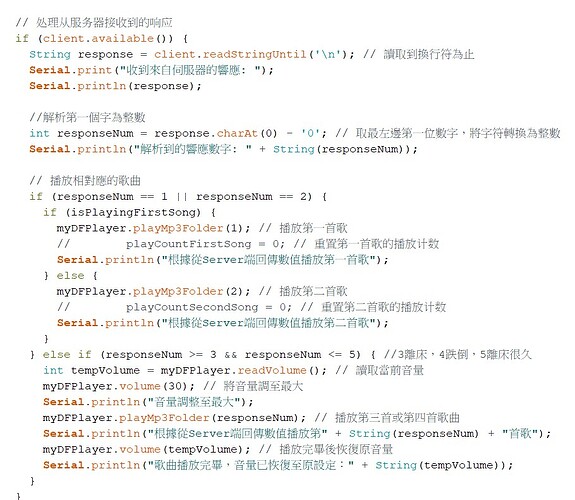

DFPlayer mini mp3 automatically adjusts volume
I would like to ask everyone here why I have this program: myDFPlayer.volume(30);
Will it have no effect,I want to ask you guys what should I do to get him to move.

You've posted the sketch as an image.
Apparently you believe that the sketch dwells at
myDFPlayer.play ...
till the MP3 has ended - but it does not.
It begins the play, makes the Serial.print and runs the volume back to tempVolume - all in the blink of any eye.
I'd like to ask how I can make the music play at maximum volume until it finishes playing. Thank you for your response!
Issue the volume command, issue the play command, and then monitor the BUSY pin for the track's having ended, and then adjust the volume again.
I'm sorry, I don't understand what you mean. Could you please explain it again? Thank you!

#include "Arduino.h"
#include "DFRobotDFPlayerMini.h"

    avgIndex = 0;
  handleButtonPress();
  handleMusicPlayback();
  sendStatusToServer(status); // Send current status to the server
  if (client.available()) {
    String response = client.readStringUntil('\n'); // Read until newline
    Serial.print("Response received from server: ");
    Serial.println(response);
    // Parse the first character as an integer
    int responseNum = response.charAt(0) - '0'; // Convert the first character to an integer
    Serial.println("Parsed response number: " + String(responseNum));
    // Play the corresponding song
    if (responseNum == 1 || responseNum == 2) {
      if (isPlayingFirstSong) {
        myDFPlayer.playMp3Folder(1); // Play the first song
        // playCountFirstSong = 0; // Reset the play count for the first song
        Serial.println("Playing the first song based on server response");
        myDFPlayer.playMp3Folder(2); // Play the second song
        // playCountSecondSong = 0; // Reset the play count for the second song
        Serial.println("Playing the second song based on server response");
    } else if (responseNum >= 3 && responseNum <= 5) { // 3: leaving bed, 4: falling down, 5: reminder of prolonged absence
      // int tempVolume = myDFPlayer.readVolume(); // Read the current volume
      myDFPlayer.volume(30); // Set the volume to maximum
      Serial.println("Volume set to maximum");
      myDFPlayer.playMp3Folder(responseNum); // Play the third or fourth song
      Serial.println("Playing song number " + String(responseNum) + " based on server response");
      while (digitalRead(busyPin) == LOW); // Wait for the busy pin to go high, indicating the song has finished playing
      // Wait for the busy pin to go low, indicating the song has finished playing
      // But do not block other operations
      // Handle the response received from the server
      if (digitalRead(busyPin) == HIGH) { // If the busy pin goes high, it indicates the music has finished playing, so adjust the volume back to the original setting
        myDFPlayer.volume(Volume); // Restore the original volume after playback
        Serial.println("Playback finished, volume restored to original setting: " + String(Volume));

This is my all program, When I receive 3, 4, or 5 from the server, the volume needs to be automatically set to the maximum and play the corresponding music. However, the volume is not reaching the maximum. Please advise! Thanks!
