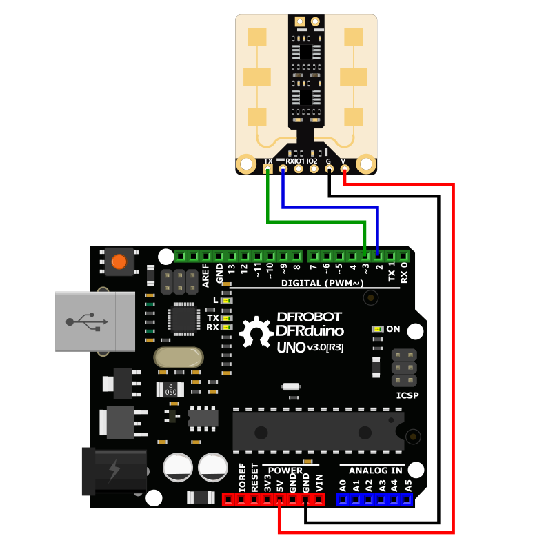

So i'm making a human presence detection using the DFRobot SEN0395 sensor with the Arduino Pro Micro. I'm using the included Example program on the "DFRobot\_mmwave\_Radar.h"
```arduino
#include <SoftwareSerial.h>
#include "DFRobot_mmWave_Radar.h"
SoftwareSerial mySerial(3, 2); //RX,TX
DFRobot_mmWave_Radar sensor(&mySerial);
int ledPin = 13;
  mySerial.begin(115200);
  pinMode(ledPin, OUTPUT);
  sensor.factoryReset(); //Restore to the factory settings
  sensor.DetRangeCfg(0, 9); //The detection range is as far as 9m
  sensor.OutputLatency(0, 0);
  int val = sensor.readPresenceDetection();
  digitalWrite(ledPin, val);
  Serial.println(val);
 ![image](https://europe1.discourse-cdn.com/arduino/original/4X/a/3/c/a3c42bf4847f7c4ca5fc602b3def0f648e355f48.png)
I followed the wiring on the DFRobot wiki but there're no Outputs on the serial monitor, just blank.
Is something wrong?

When i tried it on an UNO there're outputs but they were Janky and kinda broken cause i faced the sensor to the other side the data keep reading it was high even though there is no one.

Serial does not work at 115200 on an UNO. Try 9600 baud.
Check sensor datasheet for its baudrate.
<div class="post-metadata">
**Author:** ![blh64](https://dub1.discourse-cdn.com/arduino/user_avatar/forum.arduino.cc/blh64/32/605986_2.png) [@blh64](https://forum.arduino.cc/u/blh64)\
**Post date:** [June 4, 2024, 2:44pm UTC](https://forum.arduino.cc/t/dfrobot-sen0395-mmwave-no-output/1267681/4 "2024-06-04T14:44:37Z")
</div>
> [@Railroader](#):
To be precise, SoftwareSerial does not work at that baud rate. The hardware serial port can operate much faster than that.

Correct. I nailed 115200 but missed Software...

i dont think it's the baud rate problem. According to the Wiki the default baud rate is 115200 and when i change it, it won't work. I'm trying another Library with much simpler way to use.

The Terminal said that the Serial1 was not declared. I've tried to change it but the error message still same.

Serial1 is only available of hardware that has more than 1 hardware serial port. An Uno only has 1 - `Serial`. If you get a Mega 2560, it has 4, `Serial`, `Serial1`, `Serial2`, and `Serial3`.
which brings up back to the original help - use a different board.

> [@ridwananhar](#):
That library has softwareserial example, try that...
> **[DFR\_Radar/examples/Basic-SoftwareSerial at master · MaffooClock/DFR\_Radar](https://github.com/MaffooClock/DFR_Radar/tree/master/examples/Basic-SoftwareSerial)**
