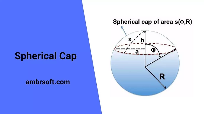

I just am having trouble calculating the volume of the tank as it has two spherical caps and I am also a bit unsure at this stage concerning the density of diesel. That ultrasonics might not reflect back from a low dense liquid.

Here is a link to a very good webpage calculating the volume of the cylindrical part of the tank.
That just leaves the end caps. I expect that the end caps are actually hemispheres. Since there are two of them you need a formula for the volume of a partially filled sphere.
This website will let you calculate the volume of fuel in the end caps;

Thank you so much for that link. I still am unsure whether I can get that big R over there. and the angles, its an actual 15kL tank. I can get on top of it but I guess I would need to draw some geometrical lines on it?
or am I missing something? is there another way to find all that?
The things I know is the cap height and cape base radius. Other stuff through geometry?
or am I missing something? is there another way to find all that?.....
The big 'R' is just the radius of the cylindrical tank. You should be able to measure the width of the tank easily then just half it. The only measurements you need are the cylinder radius and the length of the straight part of the tank. The total length of the tank will be the legth of the straight part plus twice the tank radius. There is no need to mark geometery on the tank or measure angles.
The links I sent allow you to enter numbers so just feed some numbers in and see how the results change.
