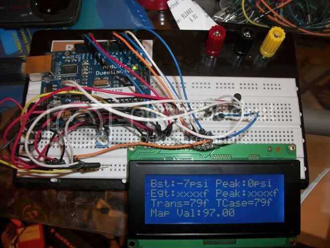

And I'm a little curious to see your project, got any pics? I want to do something similar but currently have no boosted vehicles.

Ill post pics later tonight when i get home from work. My last task is to read 1000c on 5v with an ad595, see my other post. THen my project should be close to done.

Its messy and for the time being, i only have place hold text for the EGT, im working it out right now. I plan to design a board to etch/get produced, and maybee possibly sell later to other diesel guys.
Nice work, are you taking the Tranny and Transfer case temps internally or just on the metal?
I plan to drill a hole down the center of the drain bolts (just big enough for 3 wires) then take my sensor and feed it through the top then fill the hole with a high temp epoxy. What im still toying with is weather or not i should solder a small cap on the end of the bolt to cover the sensor. Then use a 3 conductor automotive pigtail to connect it.
I still havent decided what im gonna do with the last line, bar graph of, possibly an o2 reading? Throttle Position?
