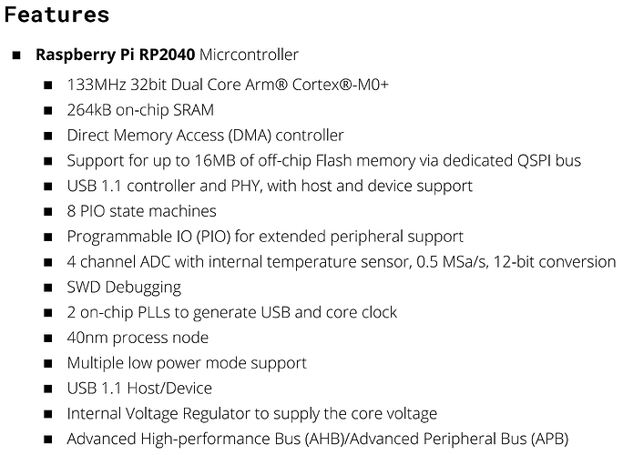

I'm not familiar with these microcontrollers but according to the datasheet it should be able to sample at up to 500ksps at 12 bit resolution.

Yes, I was getting 500 KCycles/sec using Pico Visual Studio but that system is really difficult to jump right in and I suppose they are increasing the ADC clock. Arduino is so much easier to use and I'm switching over to the Philhower core. Does anyone have an Arduino example increasing the ADC clock?
