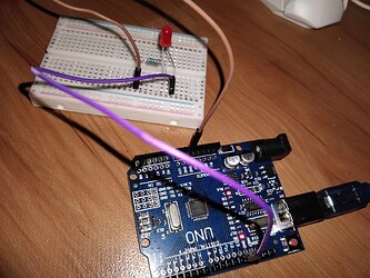

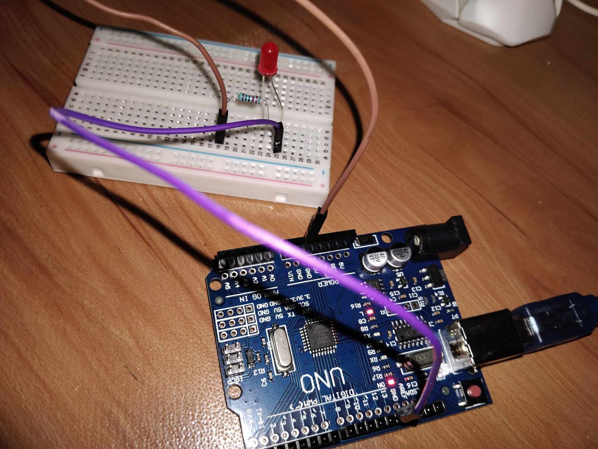

Board possibly busted?
**Board** : UNO CH340 clone
**Issue** : external LED not blinking; Digital pins not working; Tested pins 2, 3, 4, 11, and 13 so far
**Sketch** : Blink, but using above pins

 ![circuit](https://europe1.discourse-cdn.com/arduino/original/4X/d/d/d/dddbc138a2824dc96826bbbef33fd8c6ed4a1f30.png)
 ![image](https://europe1.discourse-cdn.com/arduino/original/4X/f/b/c/fbc0321c4fc445bd335d5890bcfbc7685226b7d9.jpeg)

Does the onboard LED blink when you choose 13? If so, you might have the LED backwards.

On-board LED is ~~not~~ blinking. Circuit seems correct with external LED long leg to digital pin and the other to resistor and ground

Resistor looks like 100 ohms, 1%. If you have something larger, that would be good, as this will draw a lot of current. With a red LED, you're looking at 30 mA.
If you have 200 ohms or greater (or can put two 100 ohm resistors in series), then you can test your LED independently by wiring it between 5V and GND. Don't do that with only 100 ohms, though.

R-R-Bl-Bl-Br, should be 220+-1%
Tested and LED works independently

Sorry, on my screen your image, it's brown black black brown brown. Either 110 ohms, 1%, or 100 ohms, 1%. An ohmmeter would tell you.
if 220 ohms ~3.5 V, so about 15 mA. Should be good.
Anyway, if the LED's good, you either aren't downloading successfully (should be getting an error message), or your pins are blown. I take it this is a foundling?

Then it could be a bad breadboard or a broken jumper wire or a bad led.

It was a bad jumper wire. Replaced the purple jumper wire from the original post and it worked. The 5V LED test worked because I didn't use the purple one and connected the resistor directly to 5V
