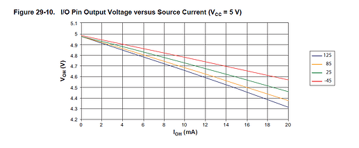

Hello,
I would like some information if available about the Arduino boards. I would like to make a 0 to 10V analog DAC using the digital outputs of a board such as the Arduino uno which will be used to control the speed of a dc motor. I understand that the digital outputs are 5 V. My question is about the source resistance of these digital pins. Does anyone know the source resistance of these pins? If so, please share that information.

It is not specified and varies with source/sink current.
You can infer a resistance from the Oupput Voltage vs Source/Sink current graphs in the datasheet.
R=(Vcc-E)/I

The source impedance is estimated to be about 30 Ohms, but you should not attempt to draw much more than about 20 mA from a pin.
You can buy 0-10V DAC modules for Arduino, featuring a boost regulator so that they can be powered from 5V.
Right... I don't think you'll find a spec for the impedance and it's usually not that important. The datasheet for the ATmega chip (Arduino Uno, etc.) says the "absolute maximum" current is 40mA (a load of 120 Ohms) and since it's "bad practice" to push things to their limit, 20mA is usually the recommended maximum.
The datasheet also says output high is at least 4.1V at 20mA. That implies an output impedance of 45 Ohms or less under those particular conditions.
I measured 27 Ω at 16 mA. But the real issue is that the average voltage of the PWM (from which the 10V is supposed to be derived) is affected by variations in the supply voltage, which can fluctuate by as much as 3 or 4%.

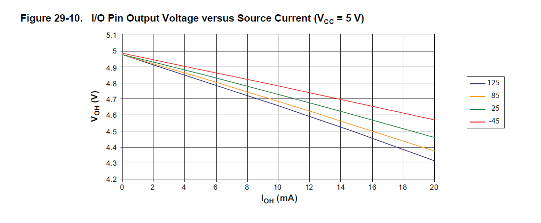

There is a graph in the datasheet that DVDdoug linked to in post #6, that shows how the output voltage varies with current.
You can calculate the output resistance from that graph.
It is equal to the gradient of the curve.

Thank you for the graph.
