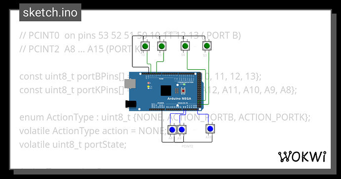

here is an example using PCINT where I only read the status of the port getting the action
the buttons in the simulation do not have bouncing to make it easy to see the result
see if that would react fast enough for you (of course printing is slow - you might want to increase baud rate)
Run IoT and embedded projects in your browser: ESP32, STM32, Arduino, Pi Pico, and more. No installation required!
source code for reference

opugh
July 20, 2023, 7:00pm
7
This is really interesting! And looks like it could well be the solution. I am looking at using 16 pins so will need to work out how to add a few more. I will give this a go and will report how I get on. Thank you!
