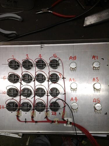

Project pics
Thanks
more project pics
Finished unit, still with protective cover on.
Sorry for such an awkward way of posting but I guess due to size of my post, it was too big. Any other pictures needed please ask as I have plenty, related to design, questions asked and problems I have faced.

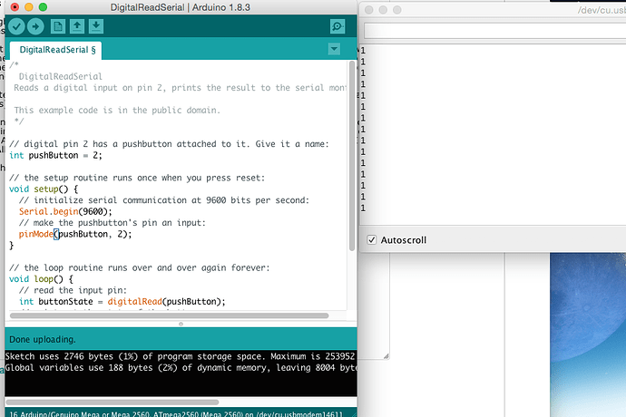

Sorry for such a convoluted post aarg, I was trying to understand how to use the DigitalReadSerial basic example sketch, to test all my buttons and not just button 2. I had no problem using AnalogReadSerial to test all 6 of the potentiometers signal, by changing each related number after A in the sketch. I was struggling to understand how to adapt sketch for my needs that was all.

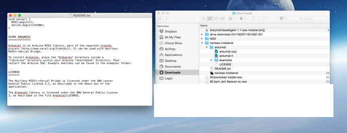

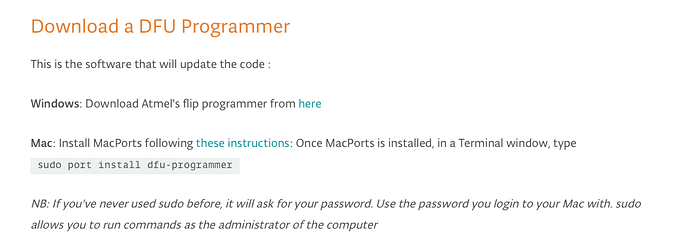

Hello again PieterP or anyone kind enough to answer.

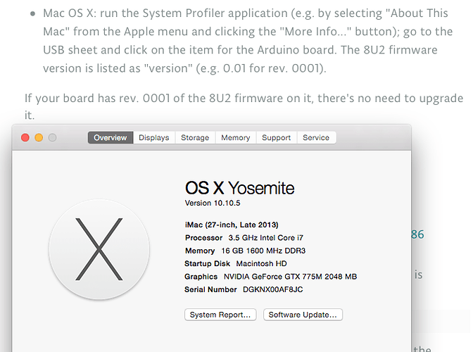

Trying to workout if I need the firmware update, but cannot find relevant info as shown in screenshot 1.
Shall I go ahead and install macports anyway?
Or as shown in screenshot 2, do I have correct settings there?

It's not a firmware upgrade. It's a completely different firmware, that turns the Arduino into a USB MIDI device. I'd recommend trying it out with Hairless MIDI first. Use Serial.begin(115200); at the end of the setup to use it with Hairless.
The MIDI controller library just sends out serial MIDI messages (because the ATmega2560 doesn't support MIDI over USB natively). On the Arduino Mega, there's a second microcontroller, the ATmega16U2 (8U2 on older boards) that takes these serial messages, and sends them over USB, pretending to be a USB COM (serial) port. You can then use a software tool like Hairless to convert these serial messages to actual MIDI messages. (They already are MIDI messages, but the computer doesn't know that they are, it's just meaningless serial data.)
This is quite cumbersome, because you need extra software to run in the background. If you want an easier, more permanent solution, you can flash custom firmware to the ATmega16U2, that translates the serial MIDI messages to MIDI USB packets. Once you plug it into your computer, it will be automatically detected as a USB MIDI device.
The downside is that you can't really program the Mega while this MIDI firmware is loaded, you need to flash the normal USB COM firmware first.
Pieter
