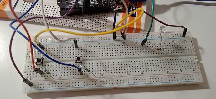

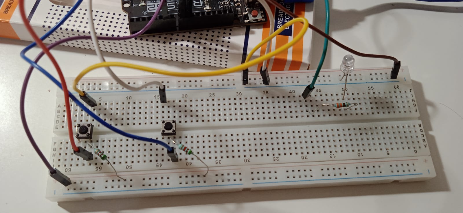

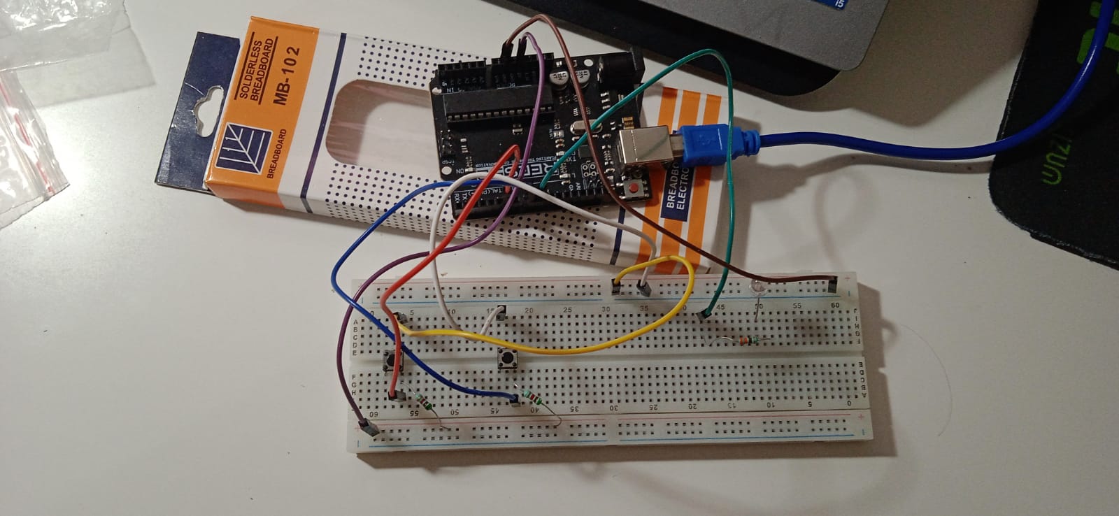

Hello, I am new Arduino. I am trying to create a Dimmable LED Using 2 Push Buttons
The problem i am facing is that button 2 reading is always show 0 even if the button is click or not
(Left button = button 1 and right button = button 2)
This is my code

Try connecting to 2 diagonally opposite pins on both buttons. I suspect that you have not connected across to the contacts on one of them

Move the yellow jumper wire from breadboard column 4 to column 2.

Thanks, Now it works
