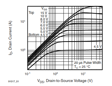

So, your LED strip draws substantially less than one Amp? Because the IRF520 is not a logic-level FET and will not turn on fully at 5 V. :roll_eyes:

Are the MOSFETs getting hot? As they are not logic level i would think they would.
