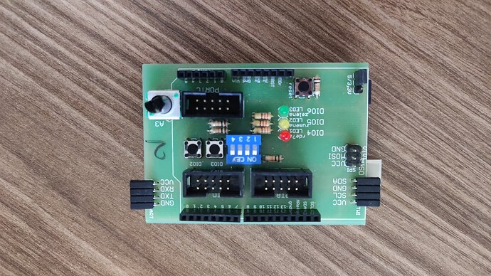

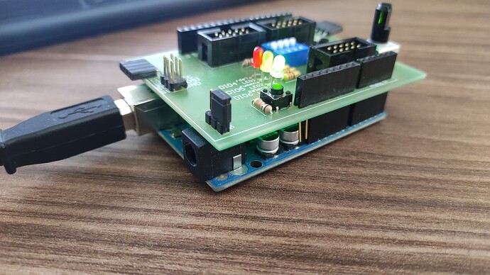

Post a picture of the setup, so we can check your connections.
Note that I have used pin2 for the button and pin5 for the LED+resistor.
Leo..
My setup works right, code from post #9 doesnt work, when I download the program the led just stays on, isnt working right.

curious, what are those 2 pins i see in pic 2, is shield situated properly??
good luck.. ~q

Where did that board come from (link).
The silkscreen says that the three LEDs are connected to D4, D5, D6.
If so, then the yellow LED should dim.
In the code from post#9 you can change ledPin from 5 to 6, so the green LED dims.
I see that the two buttons are labeled as D2 and D3, so D2 should work.
Leo..
Yea, I changed the pins
