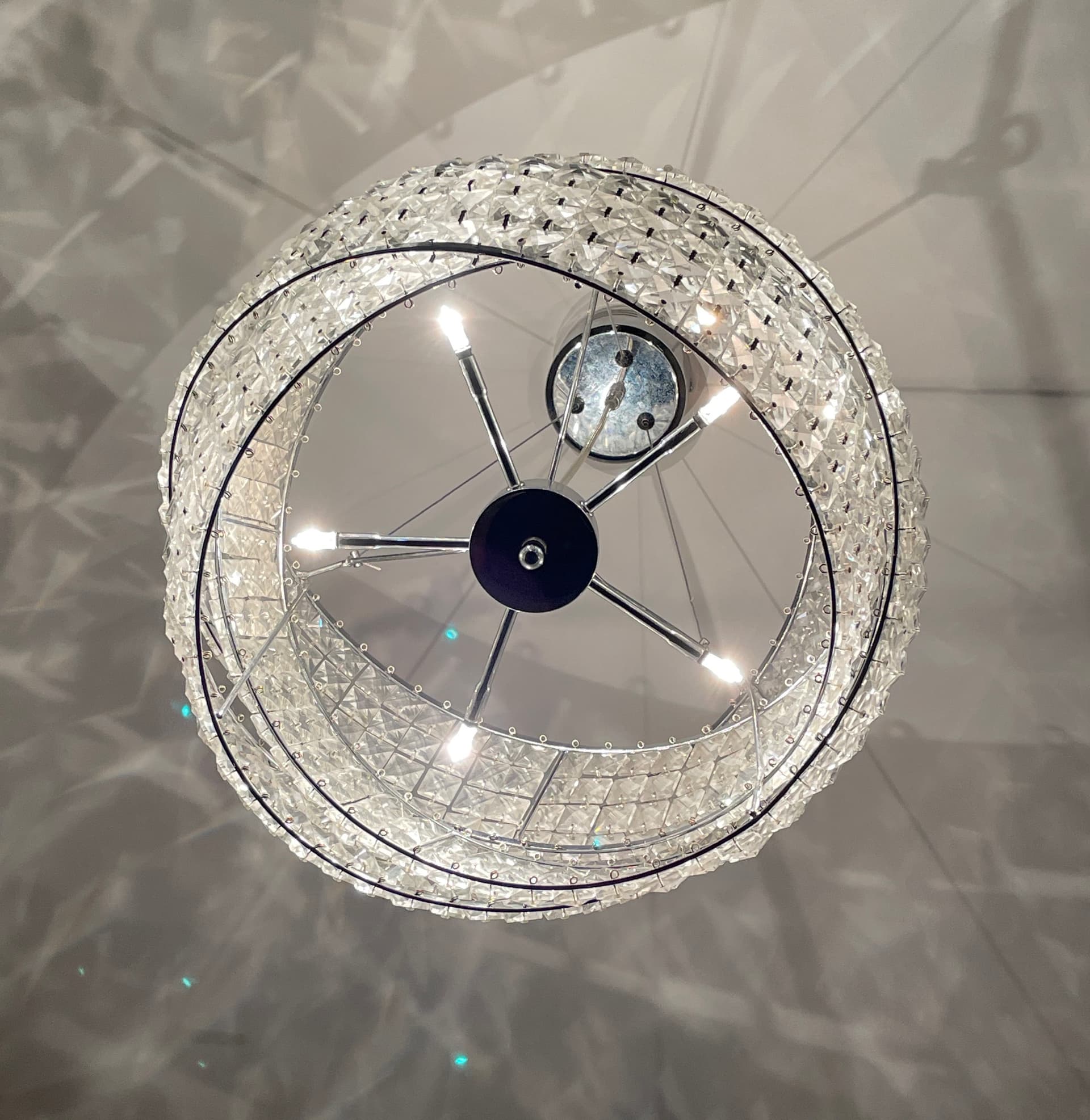

Dimming this light fitting possible? (and white colour changing too!)
Requirements :
  1. To be able to remotely dim the lamps.
  2. If at all possible, change the white colour (warm/neutral/cool).

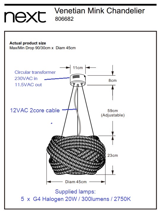

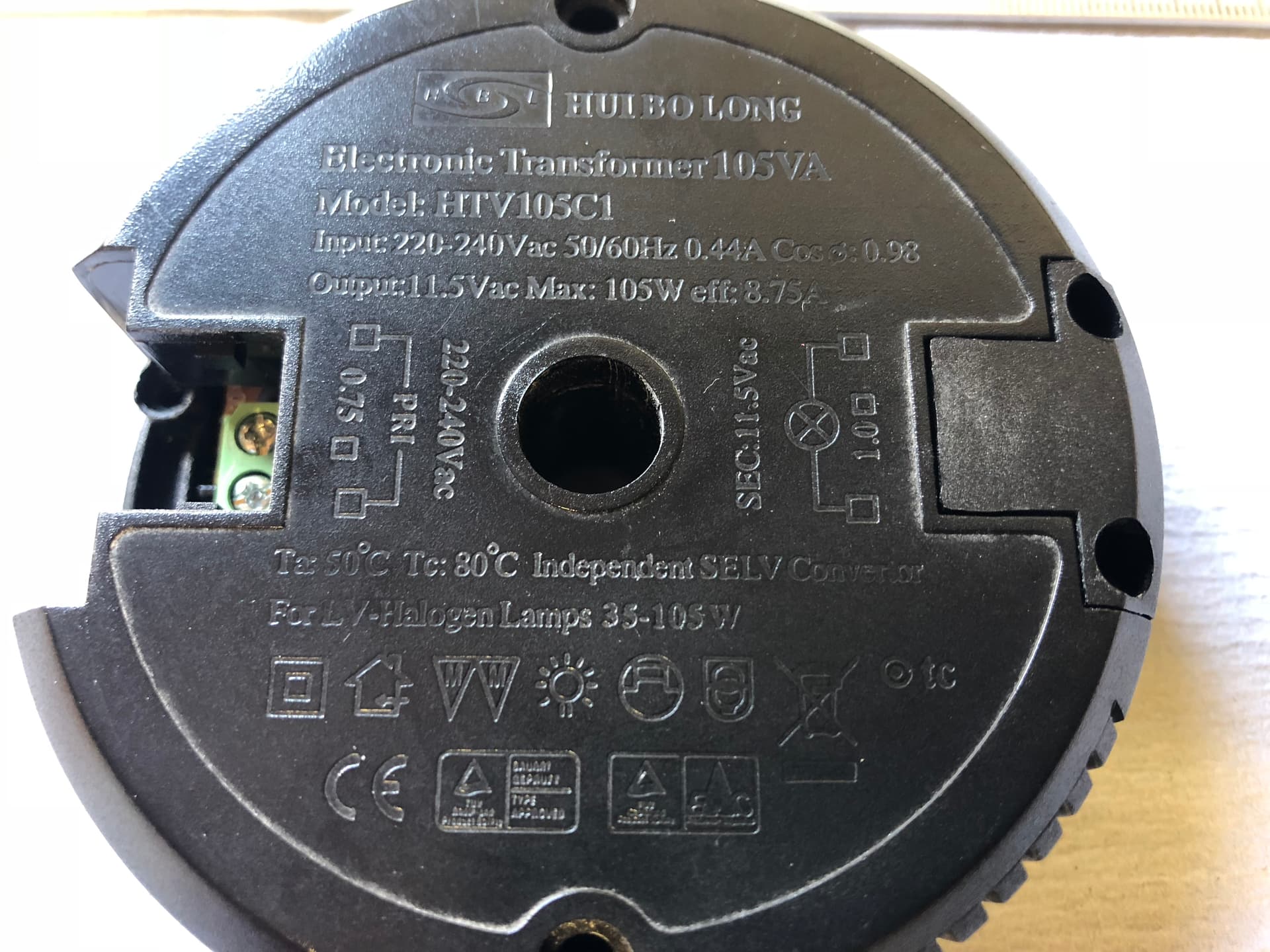

I've added the specs to the first image and details of the attached transformer housed in the top casing.
Any pointers or ideas of how I could implement this?
My home network consists of mostly Hue lamps and dimmers (no hub), Zigbee2mqtt, Node Red, Home Assistant, and I'm pretty handy with soldering and am a qualified electrician, albeit not up to date on current regs.

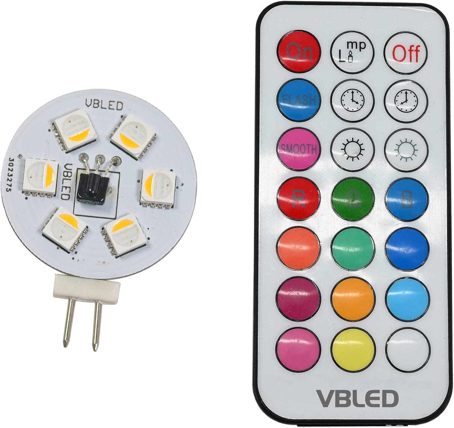

I’m open to swapping to LED bulbs, if there is a type that can colour change?
open it,
find TL431(oops, tl 341 was typo) or what ever it use for feedback circuit,
control it,
profit!
