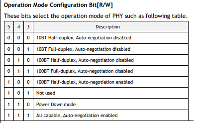

I am using a Mkr Zero with the Ethernet shield to answer pings on a network. To connect to this network, I need to set Ethernet as 100MB Full Duplex without auto negociation.
Based on the W5500 documentation, I know it is possible to set it both via hardware and software. As I don't want to try anything risky on the board itself, I am trying to do it via software.
Hence my first question : is it possible to use the Ethernet library while also changing registers without interferences ? I guess so, as my code isn't complicated :

My second, more challenging question, is : how do you actually write a piece of code that changes registers via SPI ?
I checked many websites, but they are either not precise enough or are using functions not supported on SAMD boards.
I also tried to replicate what is done in the Ethernet.h library, but functions are used and I can't find their definition anywhere else (for example, the readPSTATUS_W5200() function there : Ethernet/src/utility/w5100.cpp at master · arduino-libraries/Ethernet · GitHub).
