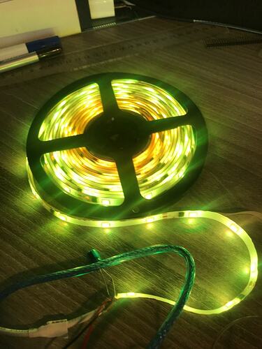

So I'm making an RGB LED Strip (5m) that has two mode: music reactive and knob-controlled colour. However my issue is with the knobs.
I have four knobs (10k potentiometers), one for Red, Green, Blue and brightness. The code works fine with when I use half of the LED strip, the colours are accurate and the brightness control works. However, when I see the full length of the strip, I start getting strange discolourations on the pixels on the end-side of the strip. This discolouration disappears if I either turn down the brightness, use only one colour at a time or use less pixels on the strip.
My PSU is rated at 12V and 10A. I am using an Arduino Mega 2560.
Have you tried powering the strip from both ends (and/or intermediate points) using wires capable of carrying the required current without significant voltage drop ?
UKHeliBob:
No, as the strip is fully enclosed in some sort of transparent silicone case. I will try this as a last resort to avoid cutting open the strip.
The strip came without a package and was advertised as 12V. Is there any chance that it is actually a 24V?
hashbrake:
Every strip I have purchased has power leads at both ends. Unroll it and take a look.
