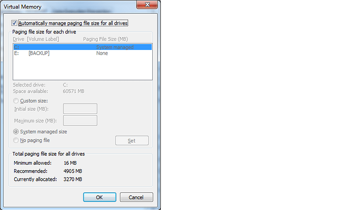

Which drive has pagefile.sys?
i cannot find any file called pagefile.anything ????
Navigate to...
Control Panel\System and Security\System
Click Advanced system settings
Navigate to the Advanced tab
Under Performance click Settings
Under Virtual memory click Change
Post a snapshot of that dialog

Atttatched
