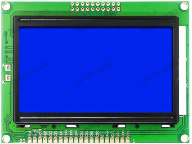

Display is not showing anything
I am using this display
Screenshot_20240121_094202
with this i2c expander
in esp-wroom-32. I used this code:

but my display is not showing anything.
Please help.
Your code references the Adafruit SSD1306 library. Your display does not appear to be an SSD1306 type display. The SSD1306 is usually found in OLED displays, and at first glance your display appears to be an LCD type display. It resembles an ST7920 type I have in front of me at the moment, but the connector labels don't entirely match up.
Are you kidding? No, I can't give you code and a circuit diagram. I've just told you that you probably don't have the display you think you have. I have no idea what kind of display it is that you have. It resembles a display I have here, but it's definitely not the same. It could have any kind of controller on it.
