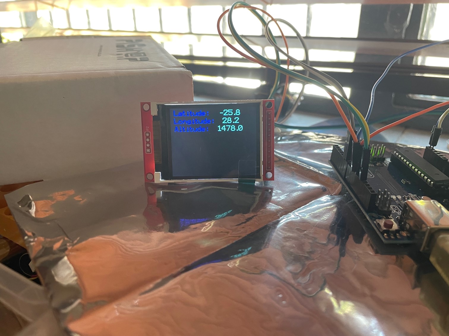

Displaying GPS latitude and longitude with more than 1 decimal
I'm playing around with a Neo-8M and an ILI9225 2" TFT display.
I have managed to get the values displaying on the screen. example 21.3 but I would like it to show 21.34567. I have tried everything I could find. I found one bit of code but the result was 213456.7.
Below the my sketch

  float lt = gps.location.lat();
  float ln = gps.location.lng();
  tft.setFont(Terminal11x16);
  tft.drawText(10, 5, "Lat:", COLOR_BLUE);
  drawTempInColour(120, 5, lt, GetColourForTemp(lt));
  tft.drawText(10, 25, "Lon:", COLOR_BLUE);
  drawTempInColour(120, 25, ln, GetColourForTemp(ln));
void drawTempInColour(byte x, byte y, float temp, unsigned int colour)
  char buf[16];
  dtostrf(temp, 6, 1, buf);
  tft.drawText(x, y, buf, colour);

Any help will be very much appreciated.
Have you tried just a plain...
Serial.println(f, 6);
where f is defined as
float f;
I,m sure that those should be cast as floats , for starters
I have tried both. Thank you. none worked so far.
on my serial monitor I get all the information. This problem I'm facing is that on the TFT screen I only get the short numbers.
Serial monitor
picture of the TFT screen
What I'm trying to accomplish here is to have the latitude and longitude readings to the 5th decimal. as per the Picture1 I'm only getting to the first decimal.
Look up how dtostrf() is used and fix this line.
Did you post the correct sketch? I do not see any tft code that matches what is displayed in the picture.
This is the code used for the TFT screen I got to work.
Below is the TFT code I tried but I was not able to display the GPS float information.
