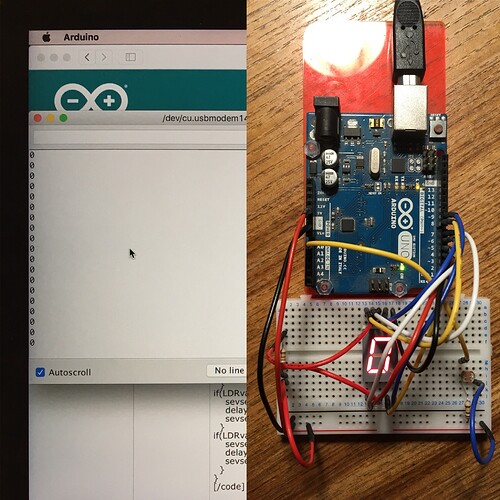

Hopefully this isn't the wrong part of the forum to ask about my problem - I hardly use it.
As of a few days ago my serial port (it seems) has been acting up: before, I could attach an LDR (with 10k ohm voltage divider) with no problem and see the light level in the serial monitor with some basic code. Ever since I tried making this circuit, it hasn't worked properly and when I am sure everything is properly connected the serial monitor just reads 0. I'm thinking that it's a communication problem between the board and the computer as when I try a simple LDR program on another board nothing comes up on the serial monitor, though that wouldn't explain the lack of expected results when I plug it into the mains.
What I want to happen: Arduino receives LDR (10k ohm resistor with voltage divider) data and displays it on a scale of 0 to 9 on the 1 digit 7 segment display (1k ohm resistor, common anode) I have connected. I can confirm the 7SD is working fine, as it too reads 0 only. (I know the code could be more efficient but I couldn't be bothered.)
I have included a photo of the Arduino with breadboard circuit and serial monitor, but say if you need a wiring diagram for clarity.
Your help would really be appreciated!
Here's the code:

From your photograph:
The bottom row of holes on the breadboard is not connected continuously from end to end.
There is a break in the middle of the row - This is indicated by the red marking on the breadboard.
You are relying on this track being continuous to supply 5V to your LDR / resistor. With the break, you will always have 0V going to the analogue pin (and hence the reading of 0)..
John, thank you so much - instant fix. I feel stupid now - I have been under the assumption that this was all 1 track connected continuously.
It works just as I wanted it!
No need to feel stupid, it's an easy mistake to make - I bet the breadboard isn't supplied with full instructions on what their graphics actually represent.
Glad to be of assistance.
