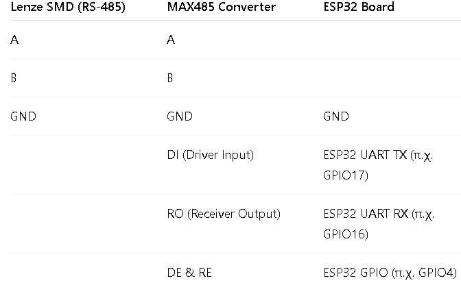

I am currently using a Lenze SMD Inverter, model ESMD751L4TXAXX1H24, and I would like to know if there is any official or simple solution to display the values shown on the inverter’s built-in display (such as frequency, error codes, etc.) on a Smart TV.
My goal is to remotely monitor the basic operating data of the inverter in a clear and accessible way.

The datasheet for the inverter ought to tell about existing communication options.
you mean that 71, 72 output could connect with a RS485 to TTL converter combining an esp32 that serves a site?
Can't tell as I have not seen the datasheet.

The document shows it devices supports RS-485 and MODBUS. No further info in that doc. Study MODBUS and ask the company for more documentation.

Lenze SMD (RS-485) MAX485 Converter ESP32 Board Σημείωση
A A RS-485 data +
B B RS-485 data -
GND GND GND Κοινή γείωση
DI (Driver Input) ESP32 UART TX (π.χ. GPIO17) ESP32 στέλνει δεδομένα
RO (Receiver Output) ESP32 UART RX (π.χ. GPIO16) ESP32 λαμβάνει δεδομένα
DE & RE ESP32 GPIO (π.χ. GPIO4) Ενεργοποίηση driver/λήψη
