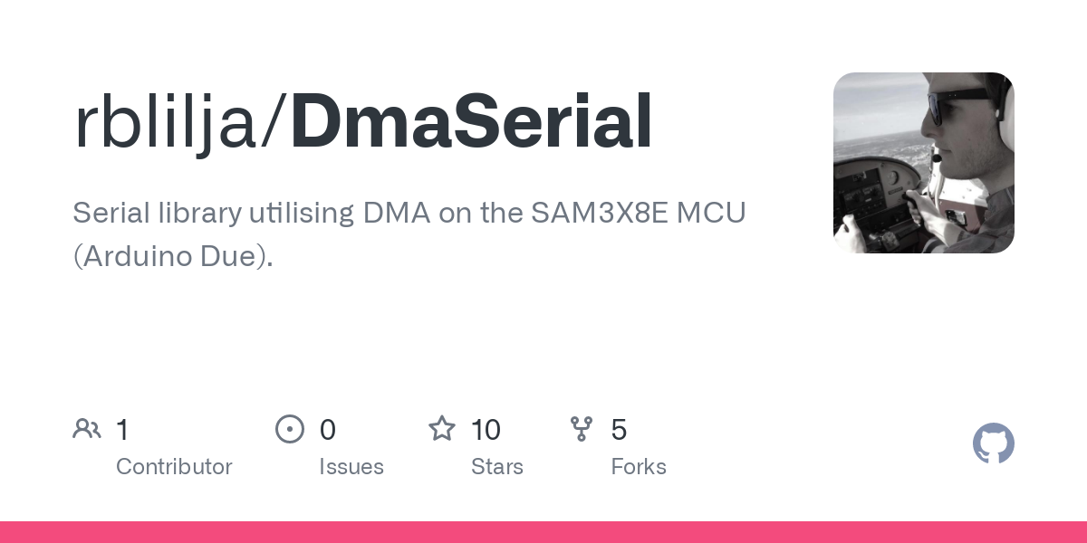

Did you have any success using rblilja's DmaSerial library?
I couldn't make it work commenting the lines it said to comment and everything, but I don't have much experience using 3rd party libraries.
