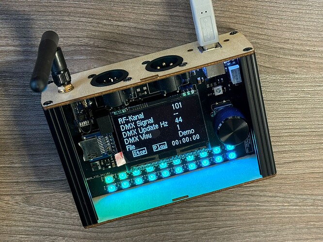

Transmitter:
  • Hardware:
    • RP2040-Stamp
    • E01-ML01SP2 (NRF24L01+ Module with PA)
    • Isolated DMX Input
    • 128x64 Pixel OLED
    • 21x WS2812B LEDs (to aid in debugging)
    • Rotary Encoder with Pushbutton
    • Micro-SD Card (optional for recording and sending)
  • Software:
    • DMX data is received using the Pico-DMX library with PIO support on the RP2040. Since the DMX bus runs at 250k baud, I'm expecting up to a 44Hz refresh rate.
    • When data is received, a flag is set, and the data is immediately buffered into a second array.
    • The data is then sent in 18 blocks of 32 bytes each (Byte 1: Packet ID; Bytes 2-31: Data; Byte 32: CRC8).
    • Optionally, I have provisioned for sending the data a second time - if some data are lost in air.

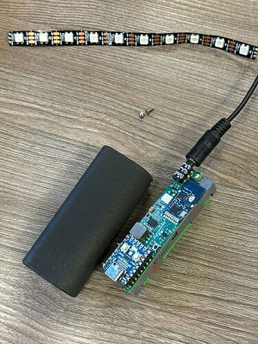

Receiver (currently 25 units):
  • Hardware:
    • RP2040 Zero
    • 18650 Battery
    • Charger
    • 5V 3A Boost Converter (for longer WS2812B strips)
    • 1x WS2812B Status LED
    • 1x Blue Status LED
  • Software:
    • The receiver accepts the packet, checks the CRC8, and writes the data into the DMX array.
    • It then sends the data to the WS2812B LEDs via PIO (NeoPixelBus).
