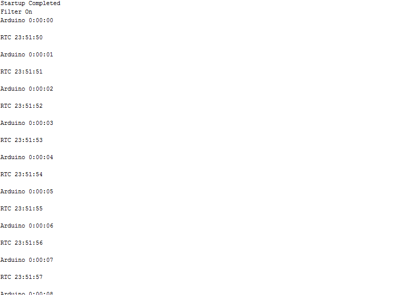

Ok guys, got my DS1307 today, wired her up and shes working fine, however got one problem, the alarms wont trigger ! - any idea where im going wrong here as ive been reading the examples etc and cant see anything obvious -

Hi MattHadfield,
Are you saying all other functions (leds, etc) are working? When you push the button you get the Feeding cycle actions?
Have you run successfully the TimeAlarms sample sketch(s)?
How do you verify that your sketch is [u]not[/u] working...have you waited til 23:00, 06:00, etc? Or did you substitute sooner times for testing...
Nicely structured code btw :)
Cheers, John
Not the cause of the problem but, as an observation, you don't need the else after finding the pushbutton pressed unless you plan to do something specific in the future when you find it not pressed.
John,
Thanks, being a webdeveloper helps with the structuring a little :wink:
Ive run the TimeAlarms Samples, they work fine, pressing the switch the feeding cycle kicks in fine and runs, i was subbing the times to test but nothing at all happens at the time, ive tried everything i can think of, using Arduino Uno, pulling time back from the arduino works fine (See http://gyazo.com/4a7299e4d4e2c8eafaeaffd972ca5bba.png?1359500543) - Any ideas ?
I don't see anything obvious. How about putting a few serial.printlns inyour day, night, lightson, lightsoff, etc functions to see if the alarm is triggering them. At least you'll narrow it dow to a function problem or alarm problem.
Quick5pnt0: I don't see anything obvious. How about putting a few serial.printlns inyour day, night, lightson, lightsoff, etc functions to see if the alarm is triggering them. At least you'll narrow it dow to a function problem or alarm problem.
Quick5pnt0,
Its an alarm issue, theres no LED change either on the relay or on a seperate status LED, however these do work when called by the switch, so the alarm just is not triggering. - See here for Screenshot of what happens when button pressed - http://gyazo.com/804dadf4df3828d889f5abdc8c631c7f.png?1359502250
He does actually have Serial.printlns in most of those already...
I don't see anything obvious either...
Have i really managed to stump the knowledge of all the great Arduino Coders ?
Edit - Not sure if im on the right tracks here, but i thought as a test id put this in to see what the arduinos internal time actually is, and theres a mismatch, could this be the issue ?
http://gyazo.com/ee1a4d9dfa5e6e058e29bc5735d21984.png?1359503649
From the example, setTime(8,29,0,1,1,11); is included in the setup, did you put this in to test it? Other than that, it should be working.
HazardsMind: From the example, setTime(8,29,0,1,1,11); is included in the setup, did you put this in to test it? Other than that, it should be working.
Tried this, changed the alarm time to 8:30 as per the example and it worked ! So why isnt it reading from the RTC time thats my question ?
did you try the example TimeRTC? Look in the Setup(), it might be just what your missing.
