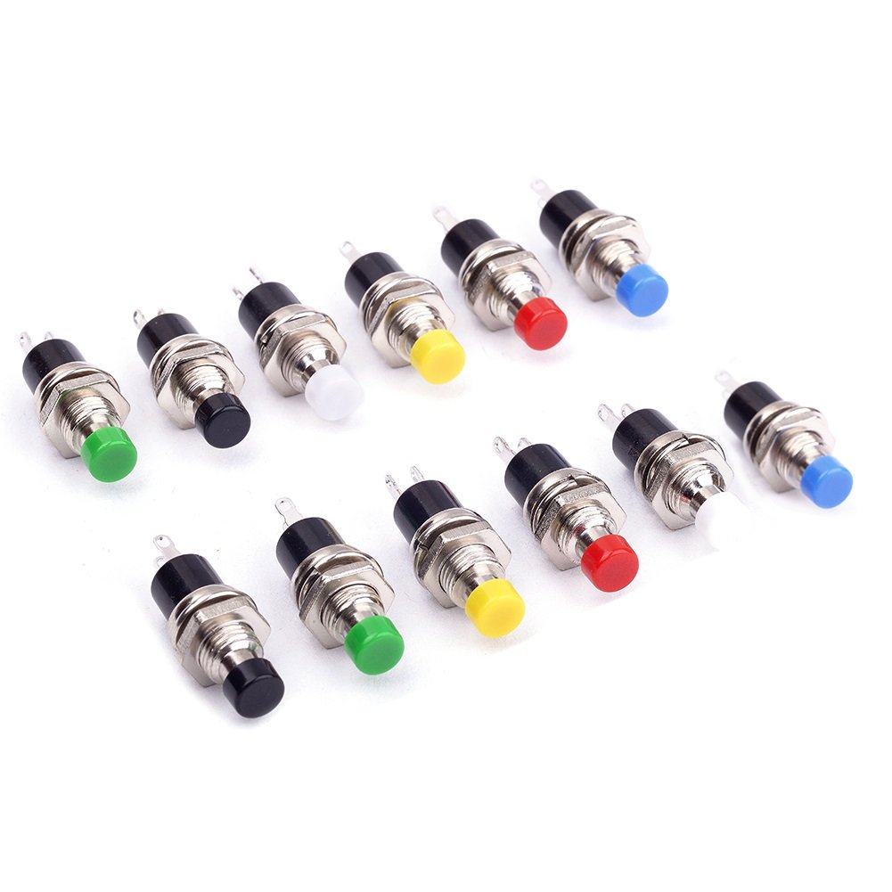

Recently picked up these sub mini push buttons
https://www.amazon.com/dp/B0752RMB7Q/ref=cm_sw_r_cp_api_i_NNjMDbA2ZDP97
They work well for small areas
200mV:
But may not have a very good "feel" by and large.

200mv: Yeah I have some of those and they're great for a lot of prototyping / utility uses. Maybe I can disguise them or re-cap them so they look decent enough in my dashboard.
Note though that these are the ones where the cap goes over a collar on the shaft. They are in my perception better than this older and apparently obsolete design as there is less sideways movement:
Yeah Paul I echo your thoughts about feel and the sideways-movement that buttons frequently have.
