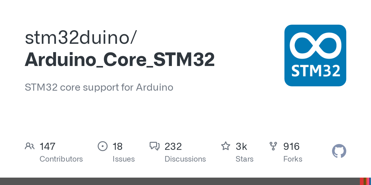

The limitation is not with the Arduino IDE. The Arduino IDE can support any microcontroller part. The limitation is whether some developer has created a boards platform for the microcontroller.
I didn't see this part mentioned in the most popular "stm32duino" boards platform, but I didn't look very closely:
I curate a list of every known Arduino boards platform here:
https://github.com/per1234/ino-hardware-package-list/blob/master/ino-hardware-package-list.tsv
You can check there to see if you find one with support for this part.
