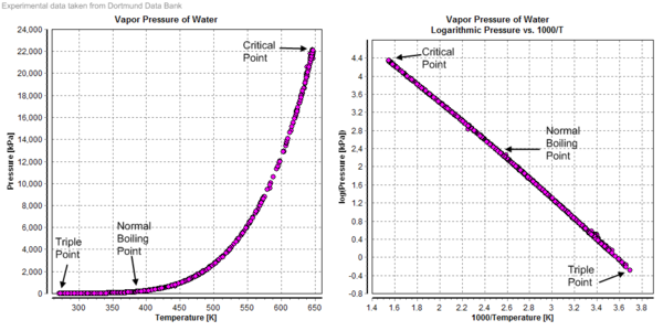

Second, there exist other formulas for what you seem to be trying to do. I don’t know how accurate they are compared to the one you gave, but here you go:
Anyway, 10x can be computed as exp(2.3025851 * x).
