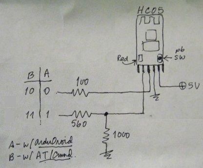

I've been trying to get an HC05 going with ArduDroid. They Pair, but I see no way, no means, to Connect. I power it up, it's blinking at a fast rate ("2pps"). I Pair and it's blinking at a slower rate (1p every other sec). [Not as long, different from the AT?Command mode blink.] I don't get/find any option to 'Connect'. TechBitar uses the 'action button', but all I get is a list of open "apps".
I found a bluetooth serial monitor for the PC. It has a 'Connect' button to click, and doing so makes the HC05 LED go into that double-blink state (indicating a [u]Connection[/u]).
I'm savvy with the wires, it's not that. For that matter, the Pair and Connect action have no Arduino interaction; all that's really required there is power.
The HC05 is set properly (see pic):

Updating with my circuit/wiring (Wow. Nobody can nail this?)

Had to give up on "ArduDroid". I found another app, though - Bluetooth Terminal HC-05 by mightyIT - $1.49 to turn off the ads. It only has 5 buttons, but you can store whatever text you want sent with each or just go on-the-fly. Eureka - something that works!
► ► My HC-05 double-blinks when it's 'connected' and the HC-05 (has the same ckt_bd w/o pb) goes solid on.
