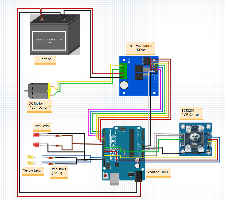

Hello, i have a complicated system and a couple questions.
This is our system and everyting is fine.

This is our code. We are doing a simple small car. it goes and if rgb sensor sees a color change car stops. We are using 12V car battery for testing, is it working or not.
everything is fine with it but we should do a chemical battery(Al-Air battery). we can reach 15V or 25V it is up to us. but i think the problem is amper because when we use chemical battery the car is not running. even arduino leds not lighting. i want to calculate what is our requirements.
Here they are:
This is our code. We are doing a simple small car. it goes and if rgb sensor sees a color change car stops. We are using 12V car battery for testing, is it working or not. everything is fine with it but we should do a chemical battery(Al-Air battery). we can reach 15V or 25V it is up to us. but i think the problem is amper because when we use chemical battery the car is not running. even arduino leds not lighting. i want to calculate what is our requirements.
You have a pin conflict. You are using Arduino Pin 1 for PWM of your motor driver. It is not a PWM pin. If you are connecting your computer the the USB port, Pin 1 is being used by the Serial Monitor. Also, Arduino Pin 4 is not a PWM pin. Search "arduino uno pinout" for pin usage.

I note you're not making use of the digital capabilities of the Analog pins (A0..A5). You can move your LEDs over to those pins, which will allow you to free up pins 0 and 1 for Serial Monitor use. As you become more familiar with Arduinos, you'll want to keep Serial Monitor running almost always.
I changed the PWM pins thanks for that but still dont know how much ampers we need. because we can make 25V battery but it doesnt move the motor.
Since the major user of current is your motor, measure the resistance of the motor connection and use Ohm's law to calculate the current it will use when connected to either battery.
I read a warning about maximum ampere and heat dissipation... if you run the BTS7680 near its maximum current (43A), you need another heat sink directly on the top of the I.C.s
