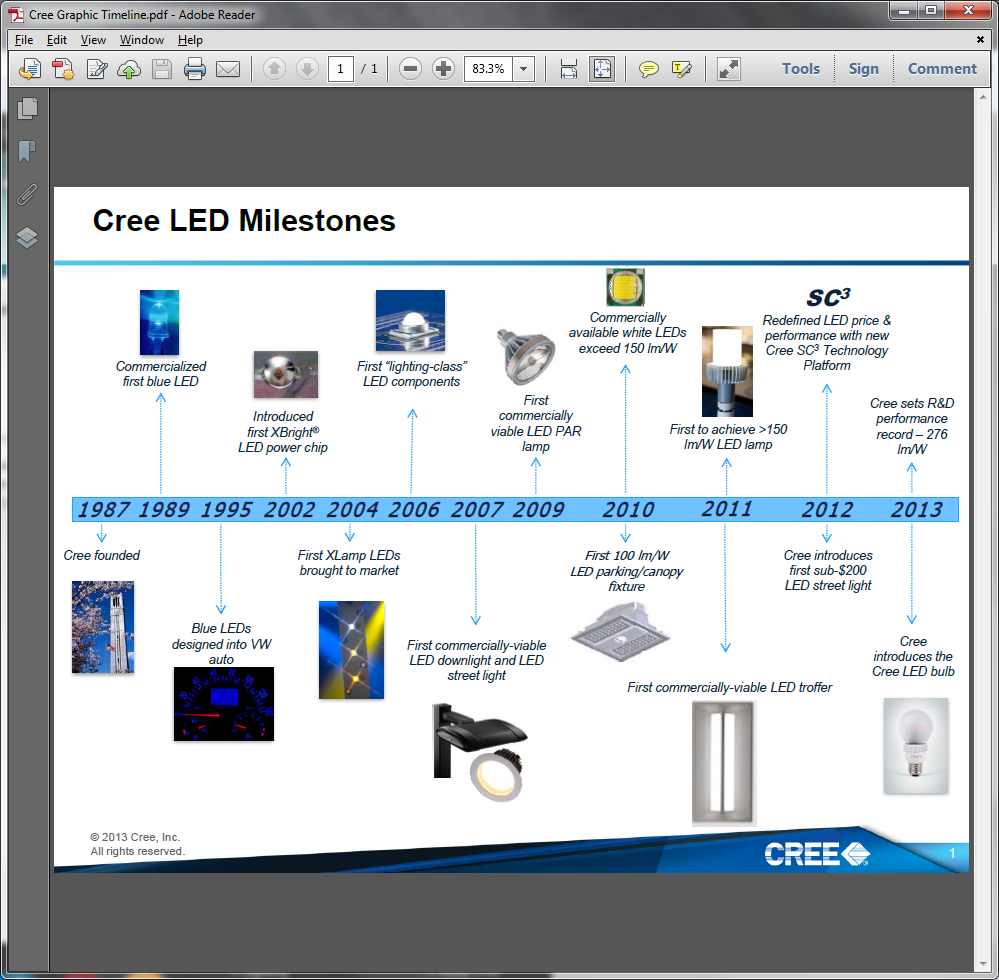

Don't know who Cree is?.....
Here's Cree's time line attached..
I think it's pretty outstanding that in 2013 they've reached 276 lm/w. if you consider a regular edison incan bulb is only a couple of lumens per watt!

Well, yeah. Except that 276 lm/W number is only in the lab, and probably at power levels less than 3W. Also, that's just the LED, and doesn't include losses in the power supply. Their current lightbulb is still under 100lm/W (although that has significant "cost engineering" goodness to it.)
According to this article, production LEDs are two or three years behind, at about 200lm/W (which is still pretty good!)
