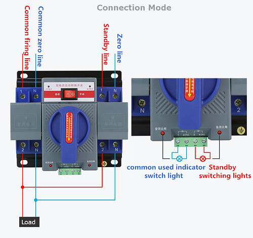

I have 2 distinct sources of 240v residential electricity on a 60A two pole (120v + 120v, ground is wired directly and not on toggle) double throw knife toggle that looks like this:
Instead of having to go to basement every time light goes out I saw this ATS on ebay and would like to
  1. Be sure this ATS switch would be a proper replacement for my toggle. (Don't worry, I will call electrician to install it upon arrival.)
  2. Assuming ATS above will work for my use case, get a very general/hypothetic concept of how "intelligent switching" command/control can be executed/implemented as per product diagram below via an arduino uno or nano with specific regard to suggested ports/wiring and commands.

thanks for reply, can you tell me what does the X inside the circle mean in green terminals above / attached picture.
Attached is the manual from manufacturer.
attachment of mfg manual wasn't accepted,, if you can just tell me what that circle with x symbol means?
I'm assuming it allows switching via an external controller. Here are pasted contents of manual.

  4. Wiring diagram
(here is just a picture as my first post)
As per wiki that symbol is an incandescent light bulb. So its just an indicator.
