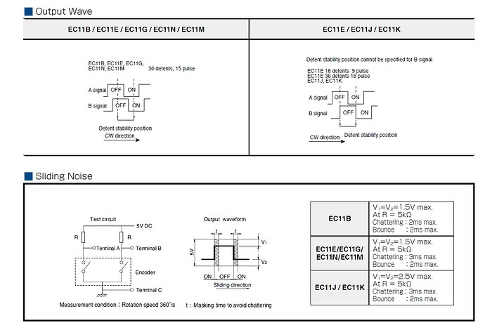

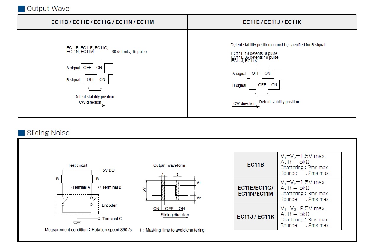

https://www.mouser.co.uk/datasheet/2/15/alps_alps-s-a0008379064-1-1733314.pdf
Forget about caps and resistors, use the internal pull-ups, with the connections you have already given.
And forget about complicated debounce routines.
The "sliding noise" is given as 2-3 msec so for the encoder all you need is a simple "if its the same after 3 msec" line.
For the push switch you can use the same routing, but I'd suggest a longer period - say 20msec.
The datasheet gives it characteristics with 5K, this would be to ensure a "wetting current" to help with the sliding contacts.
The internal pullups are in the region of 10's of KOhms.
Tom...
