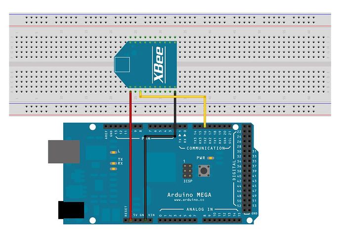

Can an arduino mega be used to configure the xbee & if YES how do we bypass the the processor .......how can this be done
melod1: Can an arduino mega be used to configure the xbee & if YES how do we bypass the the processor .......how can this be done
"Bypass the processor" is a concept you will need to explain because if you intend on using any Arduino, the best you can do is to echo the Xbee receive to an Arduino pin... However, the Arduino is still running code even then.
