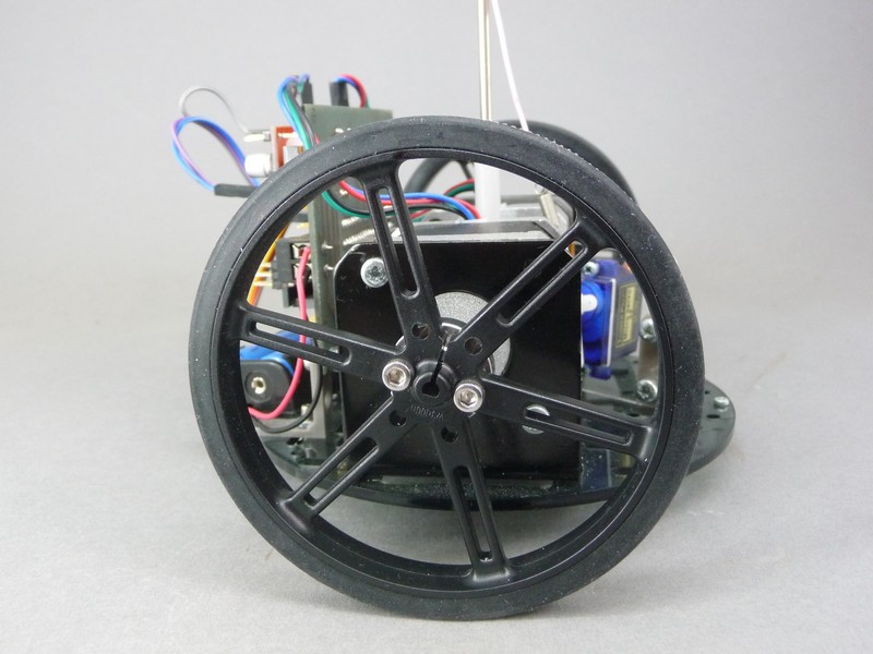

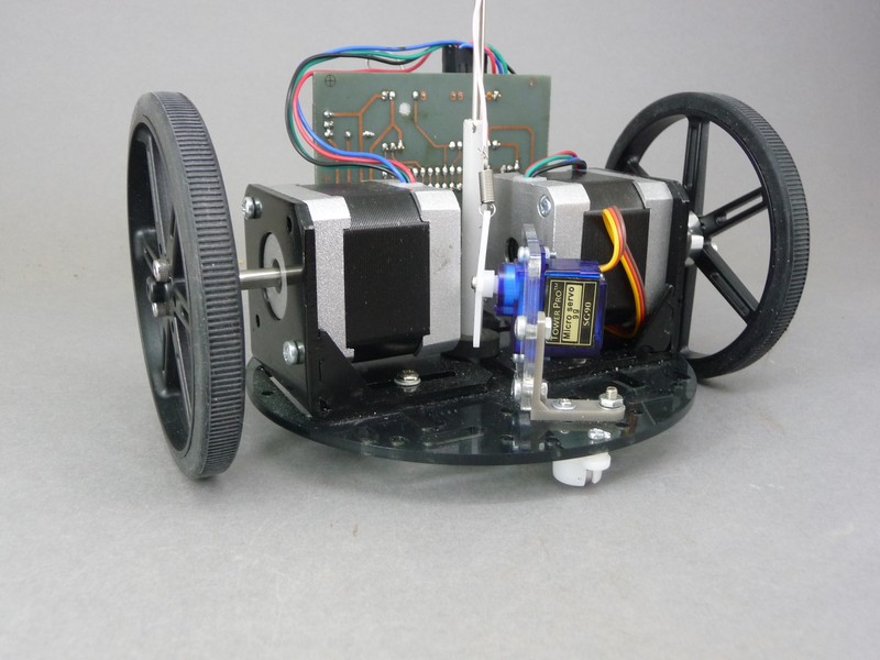

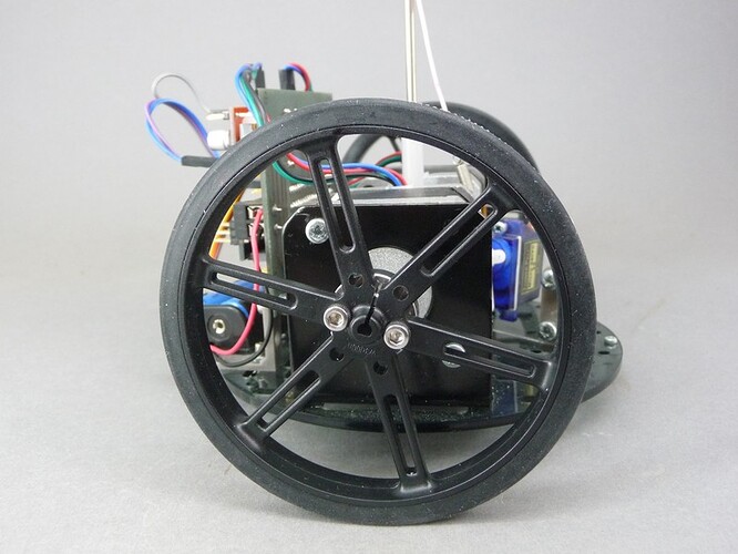

Hi Pyrus,
I have build a few bots and just done my first drawing robot! But I use stepper motors as their easy to control and predictable.. Like if you know your motor takes 200 steps to make one revolution and you know the wheel size, then you know that in 200 steps the bot will travel Wheel dia x Pi, and if one motor is still then you can do a 90 deg turn around it! in X steps..
I have done an excel sheet that does all the calaclations for you! I think I have it all right, but some one please check it for me!!
Here's a couple of pictures.. no there's not, can't I just add images?? must it be a link??
Hope it helps, regards.
Mel.

Hi Pyrus,
Mel.
PaulS:
There is a thread in Website and Forum that shows how to attach pictures.
Thanks Paul, I never found what you said, but it sort of happend, know I'd done it before, I need more forum practice!!
I thought you could add them in-line too.
Regards
Mel.

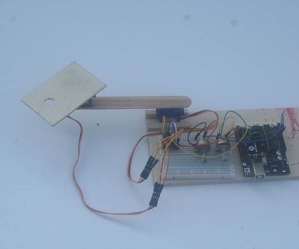

Perhaps I should have made myself clearer. What exactly is not understood in my question? What information may I provide to give you what exactly is going on? I'll just bulletin point some main aspects of my project:
  • I am using Arduino Uno.
  • Both servo motors are model "TowerPro SG-5010 Double Ball Bearing", here is a link:
  • The project is meant to be a stationary drawing machine. It does not move. No wheels are included.
  • Here is how my project mostly looks like. It's the same design, just different pieces.
  • I am trying to draw just one figure. A square. I'm using 2 servo motors to act as two degrees of freedom, but the accuracy needs much to be desired.
  • The only advantage I have is that the figure is small. So, when my servos draw a line, it is almost a straight line at first (Using only 15 degree rotation to draw that line, which makes it almost a straight line instead of a curve, or an arc).
  • Here are basically the steps I'm taking to make my Arduino draw a square: I start from the upper right corner, and draw a line from left to right. Afterwards, the Arduino has to draw a line going downward. Once this is done, it will draw a line going from right to left, and finally, it will go from upward to its initial position. But as I said, the lines keep being uneven, the servos like to act up. It's all highly inaccurate, although the main direction depending on the code I wrote does seem to be correct when I see my Arduino in operation.
-I am using Arduino's power supply of 5V for my servos.
I hope this makes things clearer, and thank you in advance one again. :slight_smile:
Hi Pyrus,
Are you saying your driving the servos from the Arduino 5v line, if so this is your problem, never drive motors or servos from the Arduino's 5v it can't supply all the current your servos need, that's why their doing funny things.... How many times do we have to tell people this?? Servos and motors need a separate power supply.

Can you post a picture of your project so we can see how you mount and setup your servos?
Can you please post a copy of your sketch, using code tags?
They are made with the </> icon in the reply Menu.
See section 7 http://forum.arduino.cc/index.php/topic,148850.0.html
At the moment we are all flying blind, you know what your project looks like and how its wired and powered we don't.
Thanks.. Tom.. :slight_smile:
How are the servos connected to the pen? Does one servo move a carriage, and the other move another carriage at 90 degree angle, on top of the first carriage, with the pen attached to it? If so, then drawing a rectangle should be relatively easy, as just one servo has to operate at a time.
On the other hand, if the two servos are linked to the pen roughly in the shape of a triangle, then you need to divide your lines into short segments, and draw the segments one at a time, for each calculating the necessary (small) movements for each servo, approximating straight lines and other figures.
This goes for the "XY" geometry above as well, when drawing lines not parallel to one of the axes, or drawing curves etc.
The problem with servos, as other have mentioned, is that you as a programmer do not know how fast they move, when instructed to go to a certain position. Servos move to the target position as fast as they can.
Hence steppers are much better for plotters, CNC routers and 3D printing.
