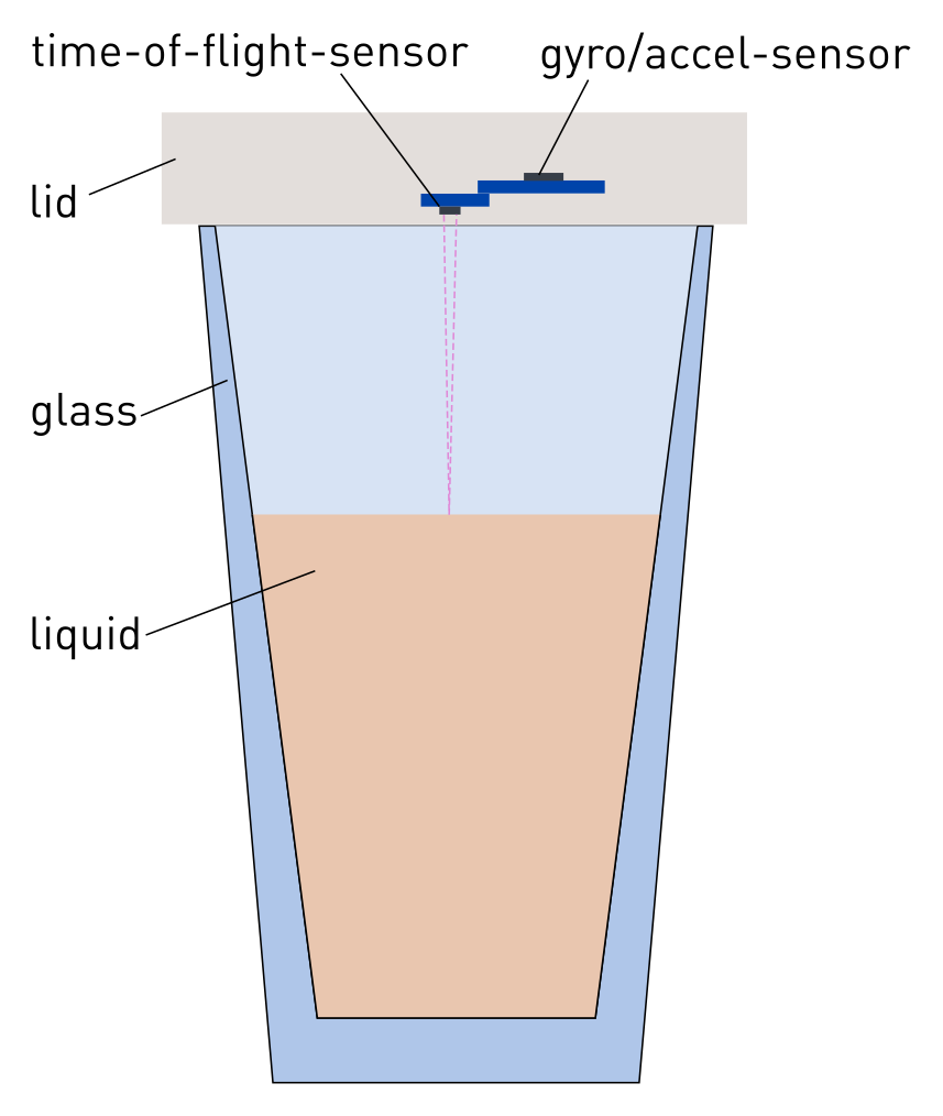

The final device will be a lid for a certain drinking glass, that counts how much you drink, and sends the raw data to the app via BLE for processing and environmental data storage. Measuring will be done by the TOF sensor from lid to top of liquid.
The shape of the glass is known, so that the app can calculate the volume of liquid that has come in or out of the glass. A calibration routine is part of my flowchart* to have the opportunity to measure the height of the empty glass in order to even more accurate volume calculations.

An update: here's an illustration of the setup, and sensor position. The ESP32 and the lipo battery are located in the lid as well.
I've chosen a TTGO T7 1.4 since it comes with bluetooth and lipo connector, while not using much space. The Nano and HM-10 BT module thus is no longer required.
