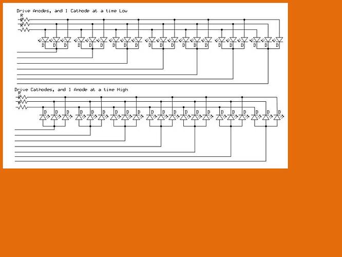

In this project I need to turn on 7 rgb leds at the same time, but every led has to show a different color. I have readed a lot of entries in this forum, and I think I need to use a multiplexer chip, but I'm not sure if I can drive the 7 rgb leds with diferent colors at the same time, only using the analog output pins that arduino has.

3*7 is 21 pins minimum. Since the Arduino UNO only has 20 I/O pins MAXIMUM you will either need to use some kind of port expansion or upgrade to a Mega.
Choices for port expansion include chips like the TLC5940 which include current control and handle 4096 levels of brightness on 16 simultaneous channels. Two of those would be more than enough to control 21 LEDs. They connect to the Arduino with SPI so they only use four data pins.

Just for 7 leds may be you don't need any hardware, except resistors.
You could use 3 PWM pins and 7 digital pins (10 total). Depends on what kind leds you have (common anode/cathode), you connects common pin to digital output, and all RGB pins run in parallel to 3 PWM pins via resistors. In code you select 1 led at a time and write appropriate PWM values to create a specific color. Read more: http://arduino.cc/playground/Main/InterfacingWithHardware#Output
That sounds good, I have to say. But since the rgb pins are in parallel, how I select by code one led at a time? My rgb leds are "common anode". You suggest to connect common pin to a digital ouput (via resistor), but how to change it for each of 7 leds?
Thank you in advance!
Let say you choose 9, 10, 11 as PWM pins, and 2, 3, 4, 5, 6, 7, 8, as digital outputs. Setting "HIGH" at pin 2 connected to anode led #1 would switch it "on". Next, you writing analogWrite (9, red_value); analogWrite (10, green_value); analogWrite (11, blue_value);
(I corrected myself, you need 3 resistors on PWM pins.) Than after delay ( 10) , you writing "low" to pin 2 and "high" to pin 3 to light up led #2, and so on.

The idea is to cycle thru the 7 LEDs quickly so it looks to the eye as if all are on.
Exactly, this is why delay is so short - 10. You could probably play around with this value, setting it higher - to 100 you 'd notice "blinking" in lighting.
