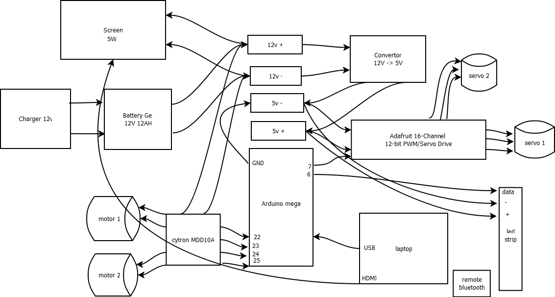

So I m building a robot for street theater (for a time when we can walk freely in the street)
It is a bit XXXXX up as I use a midi controller for thr MAO Ablteon, and then I have a java program that listen a midi channel and send message to arduino.
So far it is working.
The problem is when my battery is charging on the 220v, it is working ok. But when I m not charging, the automony is around 20 second ...
I have the following component for moving
driver : cytron MDD10A rev2
battery : 12V 12AH
motor : 12V children car motor (30000RPM)
Am I wrong with the hardware ?

The short lifespan may be things you are running that consume too much power by the sounds of it.
The motors in particular would draw a lot of current so you may want to see about reducing that.
A "schematic" as mentioned in my links would help others identify any other shortcomings.

Thanks for the help,
I added a schema, the battery and motors links.
I didn't find a lot of technicals information on the product page.
The battery charge normaly, it is working ok with the screen and the leds.
I m not sure how to test the consumtion of the motors, but when I do a test with both motor running,
I m starting with 12.6v and after 10 second running (the battery goes to 11.4), the battery then stayed at 12.6
I did this test with the robot elevated so the weel don't touch the floor, maybe the motor need more power when they move the robot.
The link for the motors gives hardly any useful specifications, alas.
Given the size they are probably rated around 50 to 150W at most, thus a few amps upto ~15A at most for a pair of them (probably less as the load isn't massive).
This is easily within the capabilities of a 12V 12Ah SLA battery that's even remotely working - hence your
battery must be completely dead.
Lead-acid batteries must be charged regularly in storage (at least every month), and must only be stored
with 100% charge. They are a real pain unless in something you use regularly. Neglect a lead-acid battery for a year and its utterly ruined.
Either a LiPo 3S or LiFePO4 4S pack will be much easier to maintain, being much more tolerant as to storage.
LiFePO4 in particular are allegedly many 1000's of charge cycles lifetime, which is something to factor into
your calculations.

That means nothing, the battery can be completely ruined (unable to power motors), yet
still manage a small fraction of an amp to power screen/leds
If the battery drops that much voltage in 10 seconds with unloaded motors, its definitely ruined. Yes, a motor under load will
need more power, a lot more power than an unloaded motor.
Did you read my post about lead acid batteries needing regular charging and to be stored fully charged?
I forgot to mention there that they will not tolerate over-discharge either, that will reduce the capacity greatly.
Never let a 12V lead-acid battery drop below 10.5V, preferrably 11V, and recharge it immediately its discharged.
