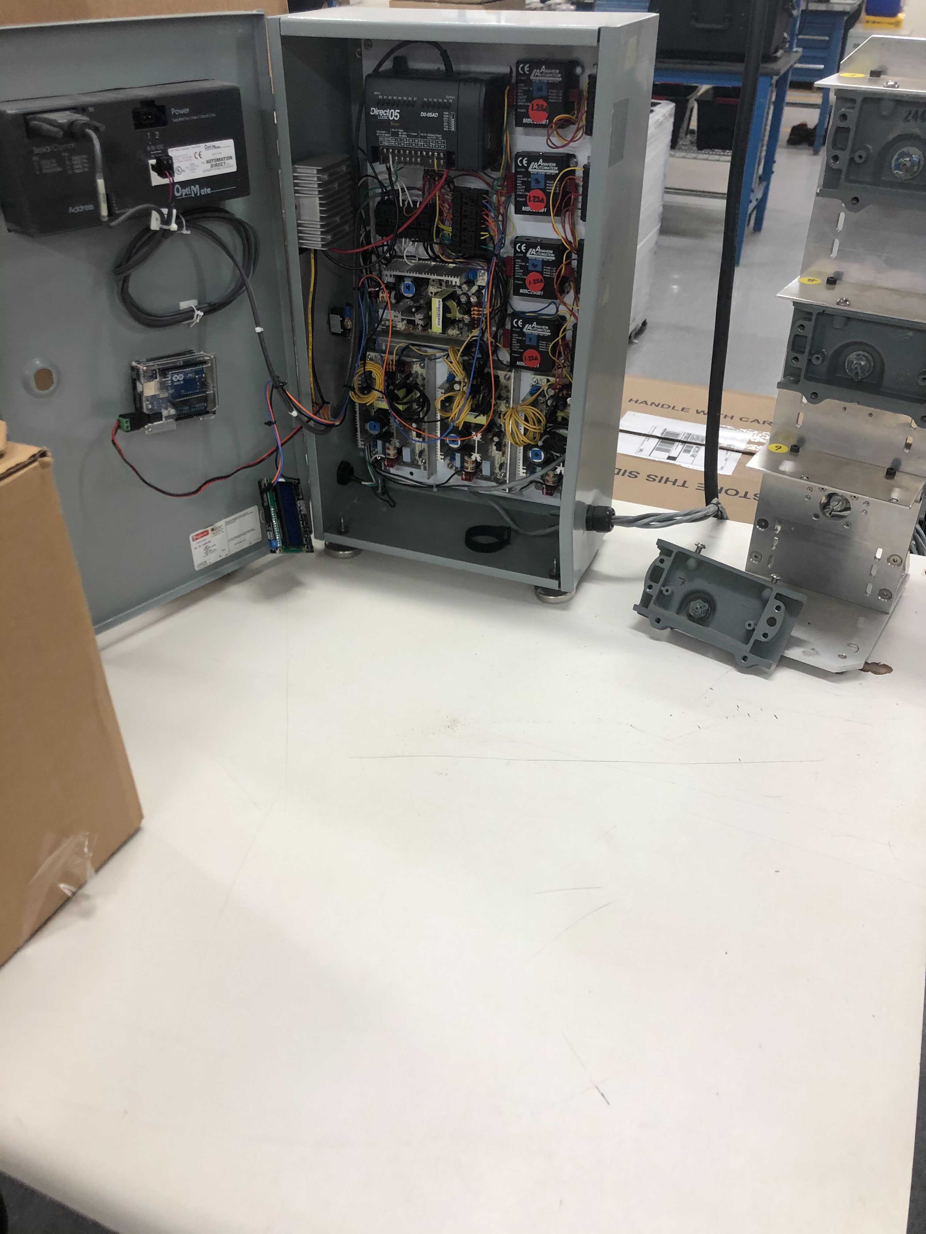

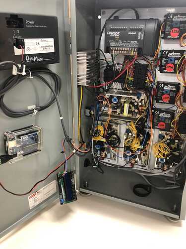

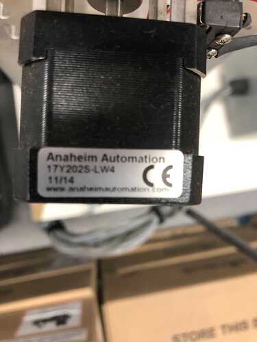

and I'll also attach pictures of my fixture and stepper, probably won't matter much but the reason I'm attaching them is I'm starting to think I may have a problem with the driver inside the fixture.
Wondering if anyone has a 200 step stepper and driver to test my code. I just ordered another one I can test on but hopefully if someone has something handy they can give me some insight.
