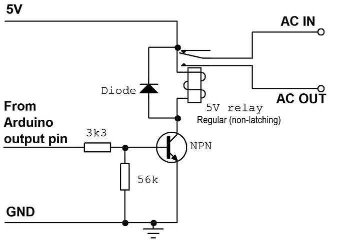

I want to know if it's possible to use an Arduino output to directly power the coils of a subminiature latching relay. The one I have in mind is the Hongfa HFD3/5-L2, which looking at the data sheet takes a 5v supply to energize the coils.
Will the Arduino be able to reliably supply the current to do this? The relay itself would only have to deal with about 20v AC (model railroad supply) and would be used to reverse the polarity of the supply. The feeling I get is that the relay would mess up the Arduino but would appreciate advice

It looks like each coil would require 40mA. An Arduino might do that, but it would be safer to use a transistor. You would just need a transistor and a resistor for each coil, plus the diode of course which you would need in any case.

Go with that feeling. Coils, even those that draw 40 mA, are bad news for Arduino I/O pins. As I read your text, your relay contacts are switching the 20 VAC - that's okay, but tell us about the device receiving that - how much current does it require, and how do you "reverse" it? I think a schematic of your intended circuit is required.

Re @jim-p 's post #7, I was wondering in particular why you needed a latching relay and an Arduino? Not sure what triggering you are using, but I'm sure the Arduino could do the toggling (latching/unlatching).
If so a circuit of the familiar sort that @ShermanP suggested, like this:
 ![Arduino-NPN-Relay](https://europe1.discourse-cdn.com/arduino/original/4X/e/d/5/ed57d9def9c2ccfd579e9e552d0ddbd80b400f30.jpeg)
But I assume you want the Arduino for more than driving a relay? Otherwise a few basic components could do so cheaply.

Thanks for the schematic.
As you say the Arduino is there for a few other functions, so it was just to try and take advantage of it

Much easier to do with a TBD62783A.
One IC can control four dual coil relays.
