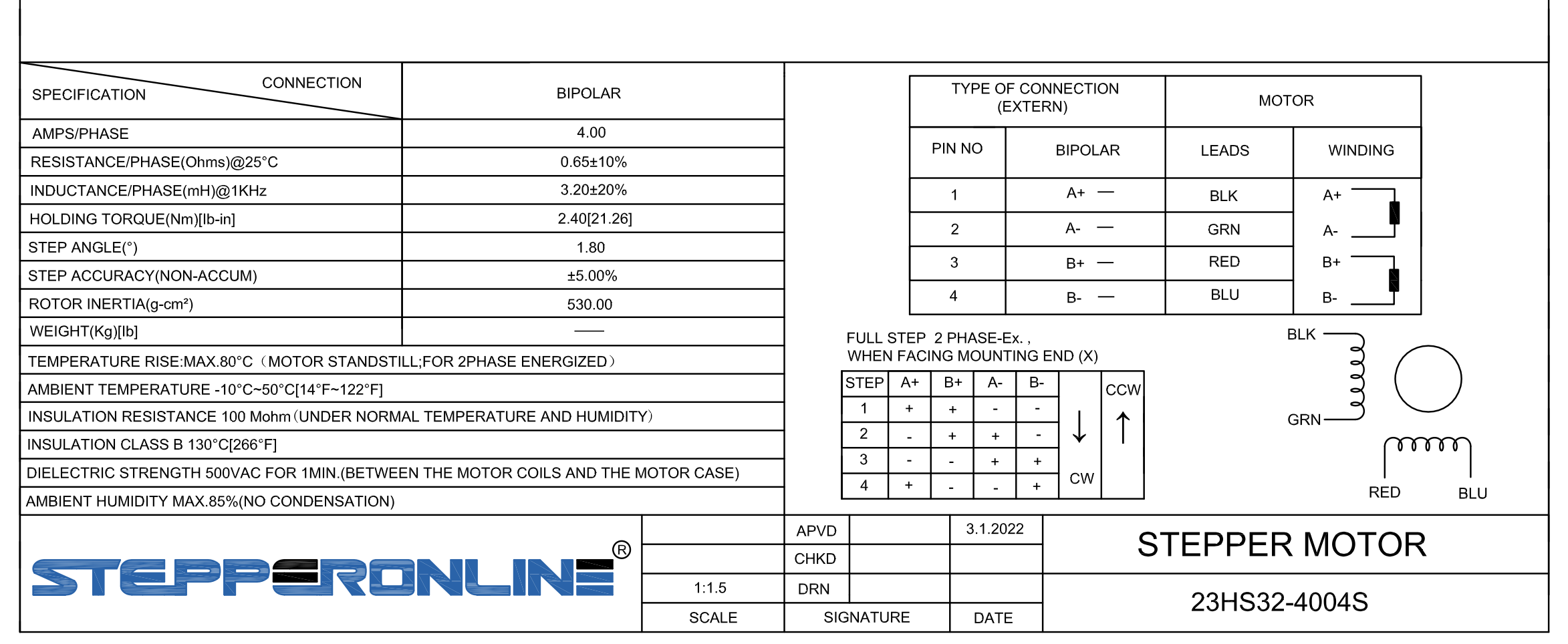

Please show the datasheet.

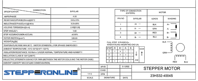

https://www.omc-stepperonline.com/fr/moteur-pas-a-pas-nema-23-2-4nm-339-79oz-in-4a-57x57x82mm-8mm-arbre-4-fils-23hs32-4004s?srsltid=AfmBOopI25pHRWcoDJ9n4en9JPdzDDoMbptU4FP-nvRtDWTWXR70JKhM

Ah. Look at the specification you linked to!!! The motor has TWO phases with how many amps per phase? Do the math to get the current setting for a controller. The current for one phase is 4 amps. Times 2 is 8 amps. No wonder the motor has no torque.

From the datasheet, you can read the 0.65ohm resistance of a coil, and then apply ohms law to see that at one of the motor coils, 4A*0.65ohm=2.6V -- the driver converts it's input power to that, and manages the stepping/current between both coils.

Wait, it's just this ? I've just misred the datasheet. Yeah you're right it's 4A per phase.
So right now my stepper is powered at 50% current, so it should hold 50% of its maximum holding torque i.e 1.2 Nm which is not the case. I'm assuming everything is linear though.

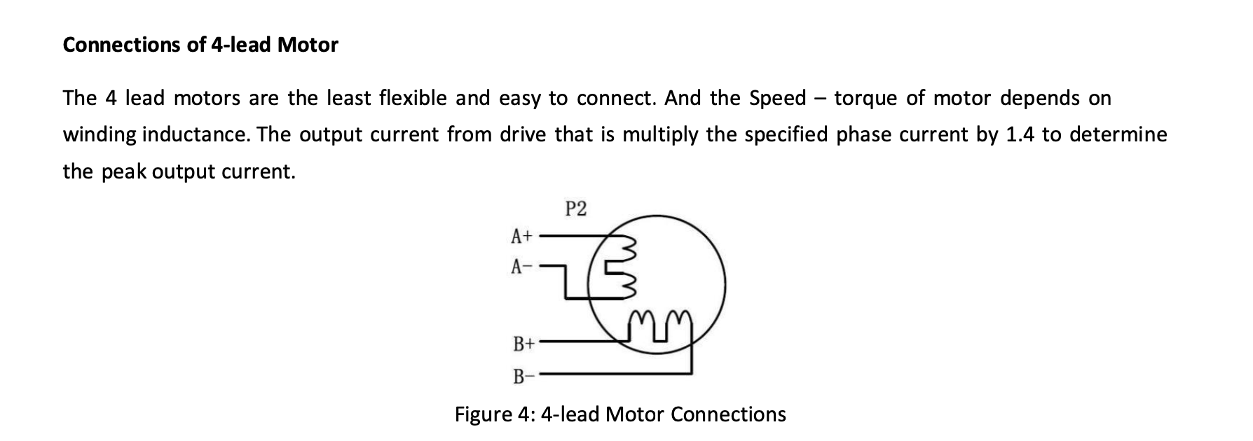

i've set at 32 microstep and 4.0 Peak current. I know that microstepping decrease holding torque but it stabilize my system. I have connected the stepper as A+ A- B+ B- following the link from stepperonline i sent you.
Looking at the dip-switch table, the highest you could set it is 4.2A peak, which with the text for the wiring of the two phases gives 4.2A/1.4= 3A per coil, and then perhaps the standstill current setting might de-rate that by 50% to 1.5A per coil.

I'm not going any deeper than a snapshot of an image from your link:
Still, that looks like maybe 4.0A/1.4=2.8A per coil.
