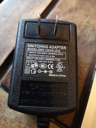

I am using a 12v 2amp switching "wall wart" power supply |375x500

I have not tried other power supplies. perhaps this is the issue? is 12v 1a wrong? is a switching supply a bad idea?
