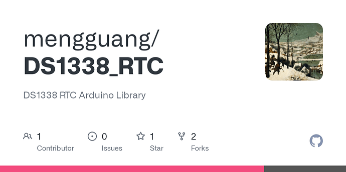

I am using this library but I think there is a problem in the month and year (at least in month because the year is in octal numbers):
#include <DS1338.h>
const char compile_date[] = __DATE__;
const char compile_time[] = __TIME__;

#include <DS1338.h>
// A structure to hold the time read from the device
struct rtctime_t time;
// A character array to hold the string representation of the time
char time_str[20];
  // Initialize the I2C bus
  Wire.begin();
  // Initialize the serial interface
  Serial.begin(74880);
  while (!Serial)
  // Once serial has been inialized, print a welcome message
  Serial.println("Maxim DS1338 RTC Example");
  ds1338_clean_osf();
  ds1338_disable_sqw();
  // Set the date of the time structure to June 27, 2014 and
  // the time to 18:45:00 (6:45:00 pm)
  make_time(&time, 017, 10, 27, 18, 28, 06);

When I use his example then I get the this result:
grafik
When he really wanted to save this information in the RTC "June 27, 2014" then it didnt work.

The comment doesn't match the code. 017 is 15 decimal.
To be honest, I would not put much faith in this library, it appears quite buggy. And DO NOT USE OCTAL!!
