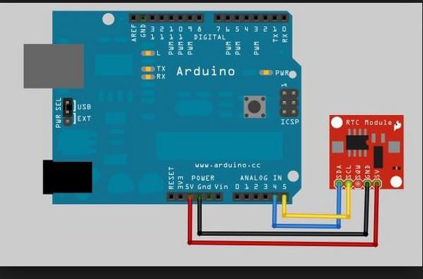

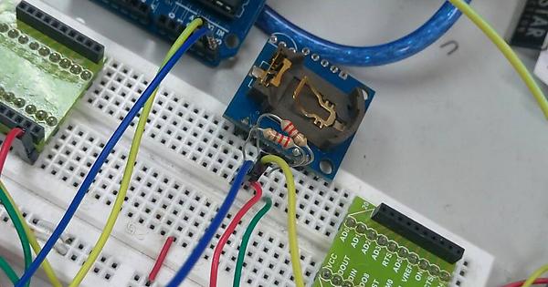

But the time i got are wrong,and keep show up the same number like this:
And the circuit i wired is here:
How can i fix that? The battery i used is CR2032 3V.But the result is same to without battery.
Thank you for read this question!
The clock does not know the time until after you first set the time. Have you set the time?

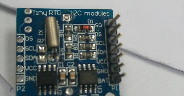

Not sure what value those pull up resistors are, 22 something ? however the DS board has inbuilt pull up resistors , so you do not need yours, remove them and try again.
Also to me, it looks like you have the I2c connections the wrong way around.
The battery is not needed in order to test run ok.
Also be aware that the DS board has a charging circuit built in, so its trying to charge your Non chargable battery.
For safe long term use, use a Rechargeable LR2032 or disconnect the charging circiut.
