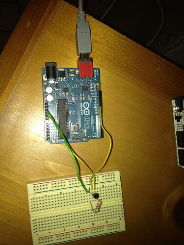

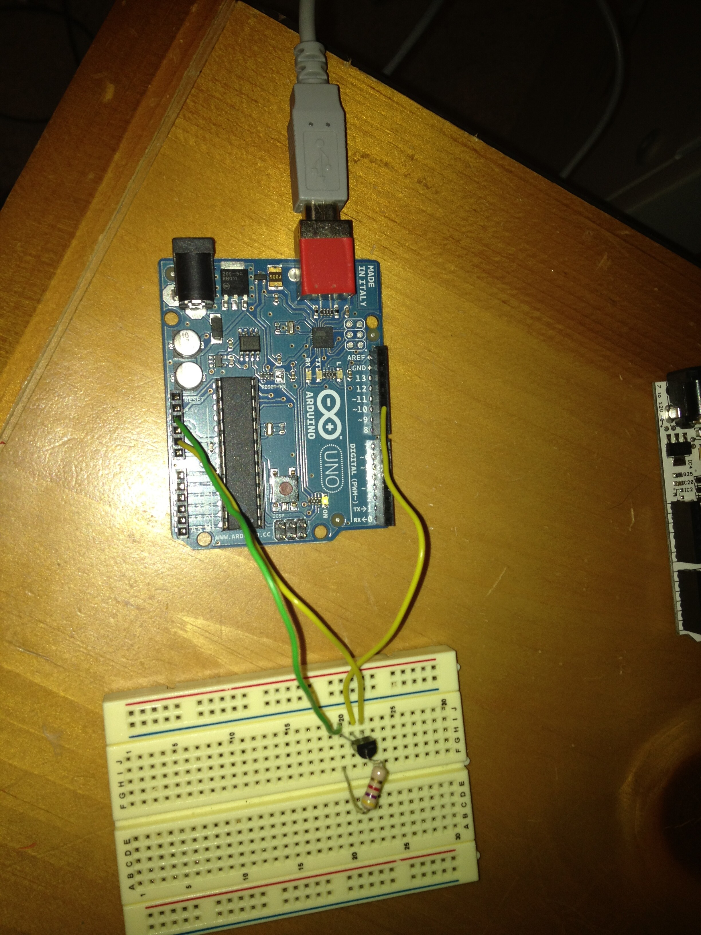

I had a hard time finding some sample code for this because most OneWire examples assume addressable devices, but the DS1821 is non-addressable, I realize most people aren't using these devices, but I thought I'd share the code out for anybody else looking.
