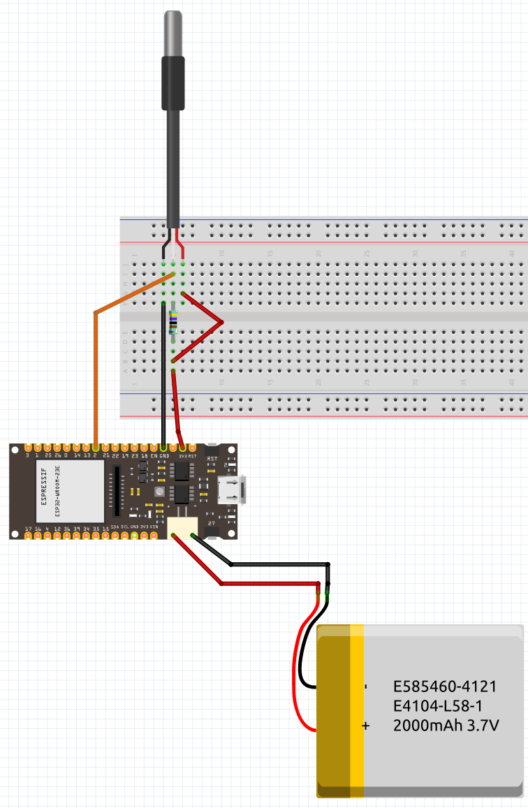

Hello, I'm experiencing a particularly strange problem with DS18B20 sensors using a FireBeetle 2: I've used several probes, but OneWire can't return a device, so it always returns -127°C on requestTemperatures.

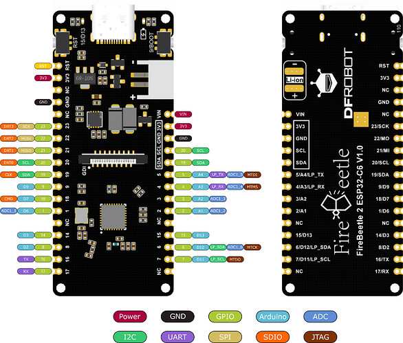

Here the pin diagram for FireBeetle 2 (ESP32 C6):
(from the seller: Firebeetle 2 Board ESP32-C6 Microcontroller Wiki - DFRobot)
My wiring is very basic using a bread board:
  • DS18B20 with VDD to 3.3V, ground and data to pin 9 (D9)
  • Pull-up 4.7K resistor between data and 3.3V (I also try a lower resistor 2.1K)
  • powering by USB C (in schematics i kept the LiPo battery as it will used with it)
Sorry for the typo in schematics I do not found ESP32-C which have a different pinout...
I used 5 different DS18B20 because I suspected it might be ko:
  • 1 of 1m from az-delivery,
  • 2 of 3m from az-delivery,
  • and 2 of 3m from a Chinese seller.

Sorry, but a reading of -127 typically indicates bad wiring or insufficient voltage to the sensor. Can you try connecting the sensors to a 5V Arduino to see if that resolves the issue? Make sure all connections are secure and double-check your wiring.
Thanks. If I found my old arduino I will try on it.
Wirings may be weak as my breadboard is not very young :sweat_smile:
Also, I just noticed that I've wrote this, is it really required?
pinMode(oneWireBus, INPUT);
I don’t think so, as the library typically handles switching the pin mode between output and input as needed, depending on whether it’s writing data to the sensor or receiving a response. I don’t recall ever needing to manually set the pin mode for this sensor.
