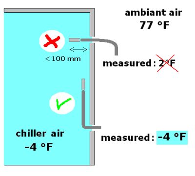

hello prankenandi-andré, I usually speak in french,
all the indications given to you are good. If the water you want to measure is a large volume (pool, tank or aquarium) whose temperature does not change quickly (with a large thermal inertia), you can use the sensor in the sleeve as you intended, it is not unprofessional! The air layer between the inner wall of the sleeve and the sensor will only cause a delay of about 30...45 seconds in the measurement, which will not be noticeable if you do continuous measurements, for example every 2 minutes.
If you fill the sleeve with a compound as indicated, you will reduce this response time, depending on the thermal conductivity of the compound.
Seal the joint between the sleeve and the electric cable with a heat-shrinkable sleeve or glue, so that water does not get inside.
If the temperature difference between the volume of water to be measured and the ambient air temperature is more than 5...10°C, the most important point to respect is this: a length of sensor extension cable of at least 20... 30 cm must be in the environment to be measured (i.e. in the water): if you don't do this, if your sensor is only immersed for the length of the sleeve or a little more, the thermal conductivity of the cable which is out of the water will cause the air temperature to modify the measurement of the water temperature.
If the water whose temperature you want to measure is a small and rapidly changing volume (a trickle of water), then yes, you will need a thin sleeve that is a good thermal conductor and filled with a compound that is also a good thermal conductor.

You must be right. By the way, if your sleeve is 40 mm long, immerse only 20 mm in water, you will make a very good measurement ! rigolo
If you are referring to the 6mm stainless steel tubes, a 10mm intrusion into water is fine.
All right. My previous post was tongue-in-cheek; I'm used to working with pros, so I wasn't paying attention to the context of this discussion. Consider the first figure, regardless of the temperatures listed. This could be your aquarium: room temperature 70°F, aquarium temperature 70°F, everything in thermal equilibrium. To measure the temperature of your aquarium, you can immerse the 10 mm probe, good thing; but you can also not bother to install the probe inside, and pull a cable through the room: put your probe anywhere in the air of the room, it will tell you the temperature of the aquarium.
sonde_2_2_2_2_2
Look at what I wrote: "when the temperature difference exceeds about 10°C".
Professional cooks have to cool down very quickly (in special refrigerators) the food coming out of the oven, before putting it on hold at 40°F, for the future meal. In the professional context, the probe would not measure the right temperature, because at the place of the red circle, a thermal flow goes from the probe (hot) to the external cable (cold), and its copper conductors very good thermal conductors: thermal flow, so temperature difference, so the sensor is marred by a temperature shift (maybe 45°F) with respect to the food to be measured, because the copper electrical conductors carry this temperature to the core of the chip. It takes (at least) twice the length of the sleeve immersed in the mass to be measured, to reduce this offset.
Same thing in the other direction of temperature differences. In order to use the probes properly, I specify that they should have 20..30 cm of cable length in the cold environment.

No you're not. The pros would tell you about thermowells whereby both the sensor and the cables stay dry - which is something you might learn about from the amateurs and children on this forum.
Have to agree - the “sheathed waterproof DS18B20 “ are simply the chip inside a sheath filled with silicon sealant and a piece of shrink fit around the cable exit - they are not workable for long term use in damp/wet conditions.
A thermowell is the solution, universally used in industry to measure gas/liquid temperatures. Easily made for “amateur “ use if you don’t want to buy one.
If you want really accurate precision best quality water temperature ( I’m pretty sure you don’t) you need stirred water anyway , insulated tank walls , lid , some money , etc and not ask on a hobby forum. ( have a look at water baths )
